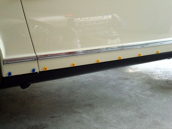

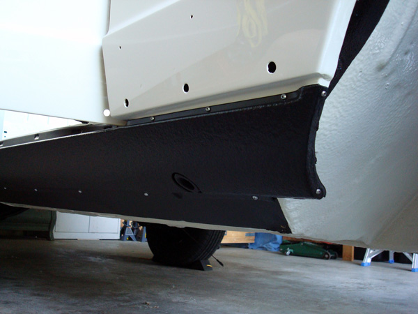

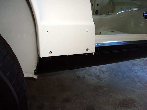

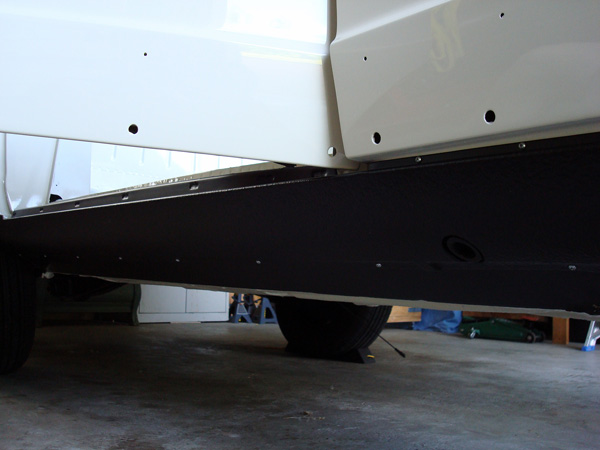

Re: Trim strips
« Reply #5 on: October 25, 2008, 05:12:18 »
Hi Mark,
Maybe a few pics will help also....
Download Attachment: holes1.jpg
67.93 KB
Download Attachment: holes2.jpg
77.38 KB
Download Attachment: holes3.jpg
60.72 KB
Download Attachment: holes4.jpg
77.92 KB
Download Attachment: holes5.jpg
82.94 KB
Mark280SL
  • USA, PA, New Hope
  • Posts: 240
Re: Trim strips
« Reply #6 on: October 25, 2008, 06:12:14 »
Perfect, Thanks Bob that helps!
