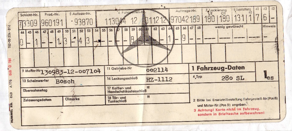

I am very seriously considering becoming part of this wonderful community of SL owners, and I am contemplating the purchase of this 280, and I would love to have your evaluation/opinions before I go drive it. Here's the link:
http://seriousmotorsports.com/webtemplate.aspx?iid=412869
The seller states that he has most of the original information and maintenance records with the car, and even attached a scan of the information card (which I am attaching). Supposedly, it is a "California Coupe" and has been converted to use R134a in the A/C. The clock does not work, but the engine and transmission have undergone a "complete rebuild by MB factory tech, all parts ordered from Germany." He says there is no rust, and that everything (except the clock) functions exactly as it should.
So, what are your opinions?

Right off the bat, you should know this is a California Coupe so there's no soft top. Just a 165-lb hardtop you'll have to remove when you want to go topless. Regardless of condition, you'll want to factor that into the extremely high (IMHO) asking price.
(Also, that's not leather.)

Another V-6!  What a factory re-build!! (Before or after pix)  Amazing.  Just saw a 'In-line 8' at Larz Anderson in Boston last weekend.  Just keep learning new things------

Really tough to tell much with pictures - here are some obvious points
  The headliner should be white
  The visors should be white
  Solid black loop carpet is not original - it should be black/gray tutone
  Aftermarket radio
  The only closeup of the paint is the VIN tag - shows poor prep and finish.
  Why do so many sellers show a closeup of the firing order??
  Original trunk mat - wonder what's under it?
Car looks complete - may be fine, driving and mechanical inspection should tell the rest of the story.
