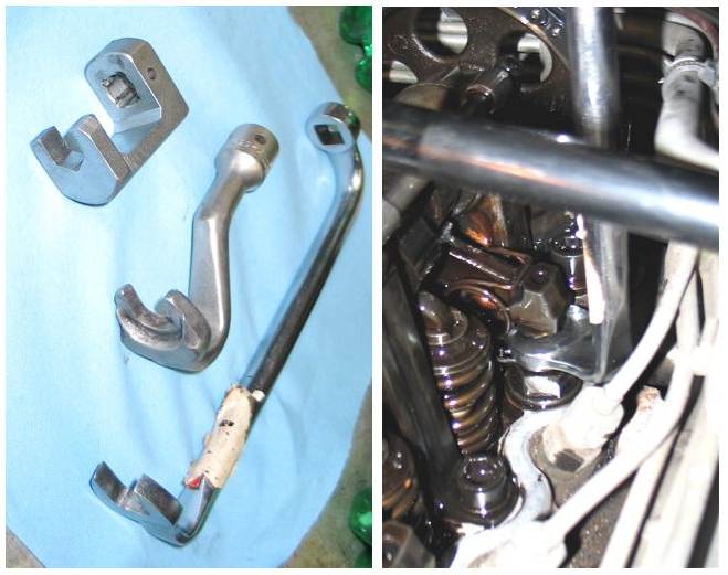

I went to adjust my valves on my 2.8 M130 engine this weekend. First of all, the adjustment nut seemed to be slightly smaller than 17 mm but bigger than 16mm. I tried two different wrenches with the same result. The other thing is that some of the nuts are hard to reach with all of the injector lines in the way. Is there a special wrench or tool for this?
I also had one nut that just would not move. Any suggestions about how to free it?

Yes, there are special valve adjustment wrenches, 17mm for a M130  and 14mm for a M127.

Use my valve 'spring compressor tool' to remove the rocker arm.  Adjust the ball stud with a six point socket.  The geometry of the rocker arm/cam shaft/ball stud thread pitch arrangement dictates the relationship between the gap and degrees of turn on the ball stud.  Should get it with two adjustments.  The socket eliminates the problem of rounding off the ball stud faces and loosens them up.

Originally posted by wwheeler
Thanks for the reply. That looks like exactly what I need. Do you know where you can get it?
Hi Wallace,
what you see in the picture are Joe A.'s tools.
The one in the middle is a 17mm Hazet tool p/n 329-3 and used ones come up quite often on eBay. Otherwise for new ones try Samstagsales.com or thetoolnetwork.com
[Just to be complete the 14mm tool is a Hazet p/n 329-2].
As far as I know the "correct" tool is NLA from Mercedes. The BBB for the 280SL shows on page 00-3/2, Fig. 00-3/5, a p/n 115 589 00 0100
-- I just noticed that you have a 280SE! The BBB shows a p/n 000589  14 0100 for a 280SE/9 3.5
[BBB for the 230SL same page, Fig. 00-3/3 shows p/n 111 589 00 0100 for the 14mm].

The M129 engine in a 250SL requires a 14mm crows foot wrench for the valve adjusters. 17mm came with the M130 (280SL).
If the adjuster screw is really stuck, follow glennards advise and use a 6-point hex socket to break the bind. Note however, the adjusters should always be very tight and hard to turn. If not they may shift themselves (and thus the valve gap) when the motor is running

I have found a 17 mm crowsfoot wrench that will work the same as the other wrenches pictured below when I use an extension. For the adjuster screw that is stuck, I will definetly have to remove the rocker arm and use the socket.
Thanks for the great advice!

I only had two adjusting screws that were really tight and had to remove the arms and use a socket to break them. One was so tight that I had to use a 1/2" drive to break it. The flats on that adjuster were somewhat rounded off, so it has obviously been a problem before. That was scary!
The other adjusters were not really loose but I think they should be tighter for a self locking screw. One day perhaps, I will replace all of them.
Thanks for everyone's help!
