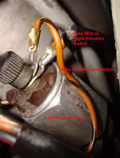

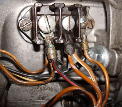

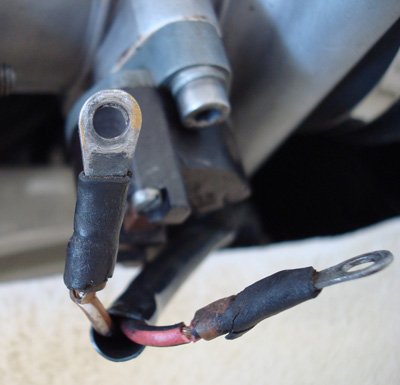

Does anyone have knowledge of the throttle switch wiring (not listed on the color schematic)?  How does this connect to the transmission?
Throttle Switch
Currently sorting out:
1. Generator light in dash does not illuminate when turn the key to 2nd position. checked bulb and it is good
2. Throttle body switch & transmission wiring ...

Bob, Been asking how this is wired and how it's 'sposed' to work-    CSS, throttle s/w, tranny s/ws, tranny solenoids, kickdown, etc.  This is all tied together on auto trannies ---???  If one thing is off, trouble??
