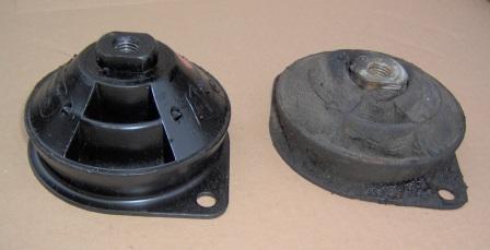

I just exchanged the rubber engine mounts on my green 250SL. Picture shows old/new... Metal to metal contact in the two old worn out mounts made the car
somewhat unpleasant to drive at times... a noticeable frame vibration.
Now gone :)
Note: Be sure to change third, rear mount (at gearbox) as well.
