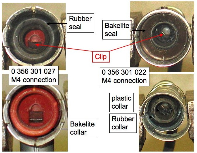

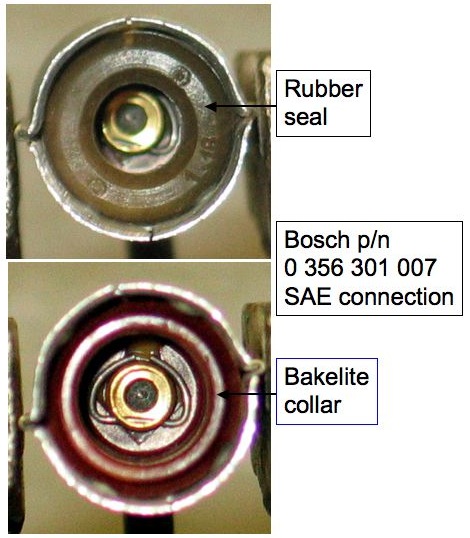

  • Posts: 4774
Re: spark plug tip question
« Reply #4 on: August 15, 2008, 14:31:51 »
Anatomy of spark plug connectors for M4 and SAE ("nipple") spark plug tips:
