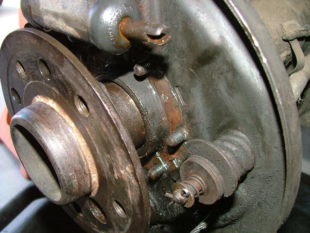

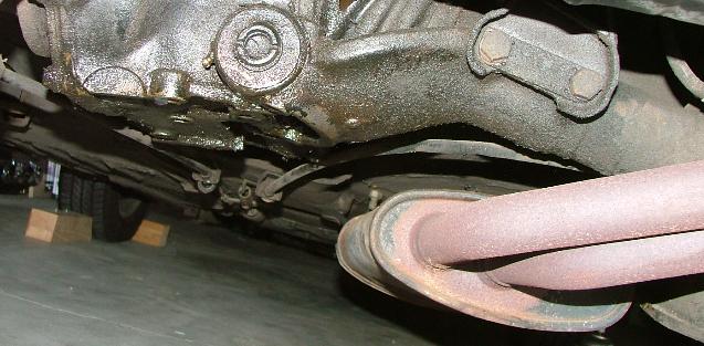

OK - not so fast huh... Very, very likely that I am doing something wrong here.
I hit it with a slide hammer, nothing.
I removed the ring (which I thought was holding the bearing ans seal in place - does not appear to be so.  This appears to be holding the rear brake plate in place).
I have attached pictures to this message in the hoipe that someone will say "That looks just like mine.  Here's how you do it..."
The axle is hanging down.  Do I need to raise it with a jack in order to remove the axle?
Thanks very much guys.  It feel like I might be close to success and, as such, will try not to press my luck in asking for too much help.
Repeated thanks,
Chris

DavidBrough
Re: 1963 230SL Axle Repair Question
« Reply #5 on: August 11, 2008, 14:05:01 »
Hi Chris,
Looking at your axle2 photo, the brake back plate comes off with the half shaft and bearing so the mounting studs need to be knocked out and anything that won’t come away with it needs to be removed first. Unfortunately mine has disc brakes so I can’t be more specific but if you remove everything holding the back plate on you should be OK to remove the half shaft with your slide hammer. Jacking up the axle tube so it is more level will also help but don’t take the weight off your axle stands which should be under the rear jacking points.

motoguzzi
« Reply #6 on: August 11, 2008, 15:17:07 »
David - thanks very much.  With the help of the link provided by Hans (and a German to English translation site) I have the backing plate totally loose and you were right, I had to remove a bracket that I beleive is unique to the drom brakes.  I have been pretty aggressive with the slidehammer but need to build a better bar to go across the centerline of the axle.  Will keep you posted.
Thanks again,
Chris
