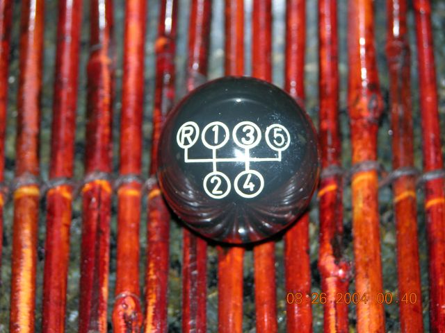

Achim, I have a similar Getrag transmission on my car with the same shift pattern as you described.
http://www.sl113.org/forums/uploaded/hauser/200482522549_Getrag%20%205speed%20knob.jpg
