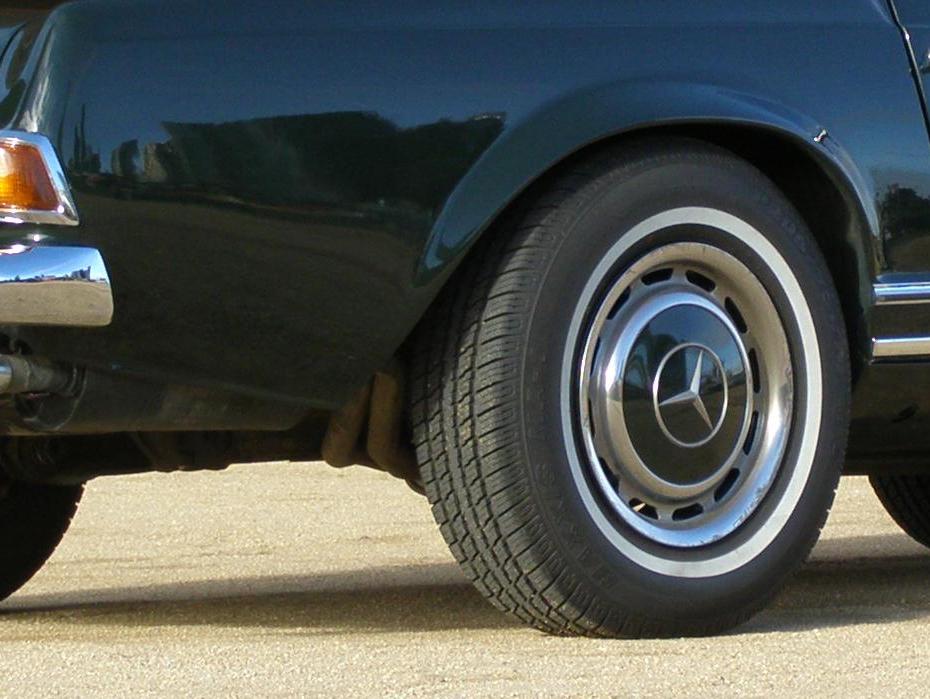

Just got a quote from Merc Classic Centre for those strips aft of the doors on the rear guards. $282 each plus shipping of about $50. Are we were talking about the same strip. See photo for my missing part.

Hey Garry, it looks like the trim you are missing is the chrome piece behind the wheel that has a rubber insert similar to the upper door piece on your door. I think Rolf's is the lower trim immediately behind door shown in your pic. The ones you need are very pricey -- but they dont require the clips. They screw on. You may be able to find a used pair somewhere -- or hit the hip --SLS shows 164 euros...each! Buds and K&K show $205 US.
Mine were also missing. Picked up a decent used pair, $60 US. Pheww.
