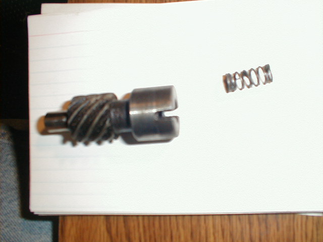

Hello Martin,
Everyone should be certain to push downward on the distributor before locking it down. A small drive spring between the distributor and drive gear tends to push the distributor upward when it is loosened for timing adjustment. If it is allowed to move upward enough the distributor will disengage and the engine will loose timing all together.
Download Attachment: Distributor drive gear.jpg
50.29 KB
If you have a weak timing light, total darkness helps a lot when timing. Try doing it at night or turn off the lights.
