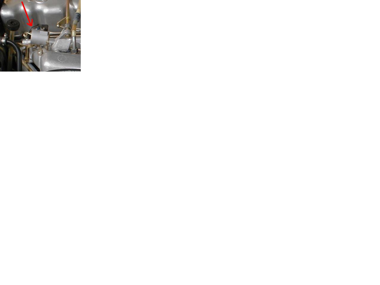

Attached is a photo of what I'm talking about, this photo is not my car but a photo of a restored 280SL I found on the internet, it has this solenoid my 70 280SL does not have. I guess from what you mention mine is on the ip.

Mark - the item in your photo is the Constant Speed Solenoid (CSS) on which we have two posts active at the moment:
http://index.php?topic=9029
http://index.php?topic=9100
It raises the idle on cars with automatic transmission, aicronditioning, or both so that the additional drag on the engine from either does not cause too much of a drop in the idle.

It gets a little confusing actually because when searching the technical manual here on the site I now see the acronym CSS refering also to a "cold start solenoid (CSS)" not just "constant speed solenoid (CSS). Obviously they are different but share the same reference. No matter though I will figure that stuff out.
But as to my original concern I'm guessing the (CSS) solenoid on my manifold is missing from my engine when it should be there because my car is both automatic and has Air Conditioning which seems to meet the criteria for having the constant speed solenoid you mention. Am I correct in this assumption?

 ... when searching the technical manual here on the site I now see the acronym CSS refering also to a "cold start solenoid (CSS)" not just "constant speed solenoid (CSS). Obviously they are different but share the same reference. No matter though I will figure that stuff out.
...After a lot of thought I have actually decided to pull the engine send it off to Metric Motors and do it all over from square one under the hood so I know I have things the way they should be and can have confidence when I take a long drive in the car, I've had enough surprises and want to make it right.
Yes, with an automatic transmission as well as A/C, you would want the constant speed solenoid in order to maintain proper idle; I reckon your idle is set pretty high in Neutral with A/C off, in order for the car to not stall when you put it in gear and/or turn the A/C on?
Actually, an engine rebuild will not address many of the things that are perhaps not original on your car; in fact, probably there's relatively little previous owners and their mechanics can have done to the engine that a rebuild will cure. Things like FI pump and its settings, fuel linkages, ignition, air filter, CSS, wiring are all things that an engine rebuild will not get into. If they would not clean the engine as a part of the rebuild process, you would hardly be able to tell the before/after-the-rebuild-difference. I reckon that if you'd post a few detailed photos of your engine bay here, we would be able to guide you to originality.
