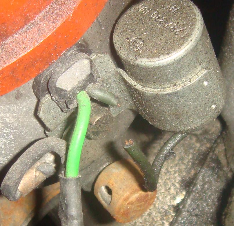

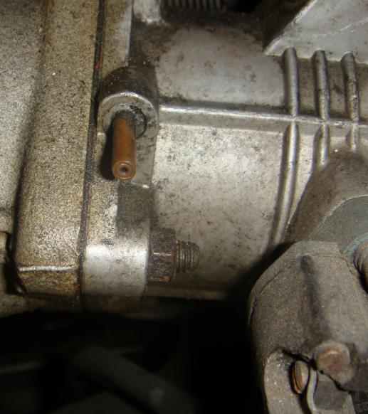

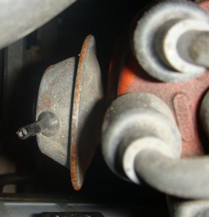

The plot now thickens. I was all set to start taking off my valve cover and then read some of the latest comments and I opened the hood and started looking around based on what you have noted and have discovered some interesting things.
In one photo you will see the wire from the condenser to the distributor is broken! I'm kind of surprised the engine starts at all with that situation but I must admit I'm obviously as far from an expert as you can get.
In the second photo I discovered there is no vacuum line at all connected to the distributor connector!, as well as the last photo where I discovered I apparently have another vacuum? hose missing from the housing leading to the air filter canister. I'm not sure what type hose I should use (one that fits right?)or where to connect the other ends to? does one hose connect these two together or are they unrelated? I guess I need to do some research and figure out what should be connecting where before I start pulling the valve cover off, at least I think? Sorry I'm so ignorant about all this.

The green wire comes from your condenser.  You need a new one obviously.  But look below to the little cap with the rotating cover.  That shouldn't be open.  You'll want to put some oil in there and rotate it so it's closed.
The vacuum line is available at most any auto parts store for sale by the foot.
It's odd that this would happen suddenly.  Anyone you know of been messing around under the hood?  Where did your hose suddenly go and what cut the condenser line?

This condition had to have been this way since I purchased the car several months ago, at least the missing hose part, I guess the wire could have come apart since then, I have not driven it much though since I purchased it. It is garaged and I am the only one who has had access to it and it has never been to a shop. I've never had to bother with anything before because it has run fine, maybe not perfect but certainly no major problems before this all started. All I've done prior to this was to change the oil.
So is it one hose that connects those two fittings ?

Yes, one hose. Connect the two together. I would pull the cap and check the vacuum solonoid and make sure it is all moving good. You can hook a vacuum pump to test it, or just suck on it to see if you can move it a little or see if  it leaks. Don't worry about that extra condenser too much. It is just for radio suppression. You might as well fix it though. It is not the condenser for your points.
