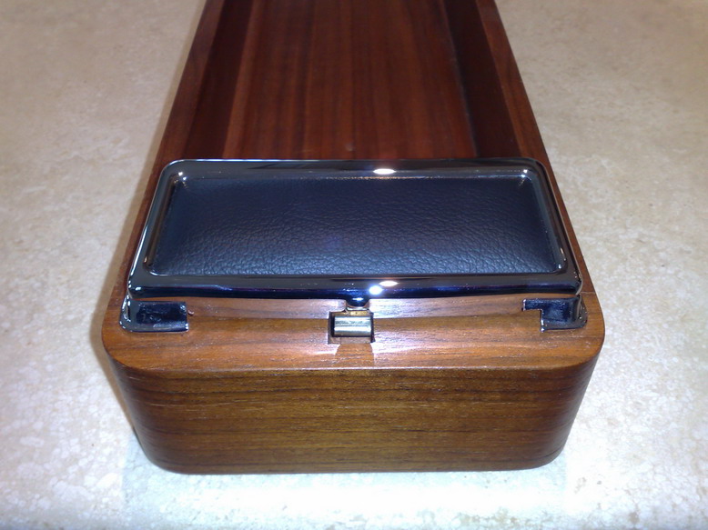

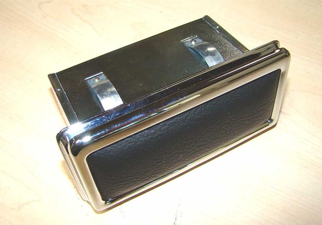

Hello:
My early 250SL is missing the ashtray but I'm confused as to which ashtray goes with the early 250SL.  Is it the flat top style shown in the first image or is it the one with the handle as shown in the bottom image?
Re: Ashtray types - early vs.late
« Reply #1 on: July 03, 2008, 16:09:19 »
I've never seen a 113 ashtray (early late whatever) with a handle. They've always been as shown in your first picture.
I see you took that second picture from the parts manual. Interesting, I've never noticed it before. Perhaps others can provide better information here.

psmith
« Reply #2 on: July 04, 2008, 00:05:47 »
I'm not sure that's really a handle.  It looks to me like the artist was trying to show a shadow to indicate the padded top is curved.
paulr
« Reply #3 on: July 04, 2008, 00:53:01 »
I don't think that the top picture is quite correct for you, I have a 280 that has a padded piece like the photo but I am sure that the 250 ashtray is flatter with the chrome being a little wider and flatter ( basic ). So I suggest that the top one is for a 280. If you stare at the bottom one  and imagine the top to be flat, that is more like a 250 one although the "padding" does still look a little mean.

Don't think that's a handle but rather, as psmith stated, it's a shadow!
suzy
« Reply #7 on: July 29, 2008, 13:49:23 »
the ashtray in my 250 looks exactly like the top picture (i think Eryk is correct--it's a shadow in the drawing, not a handle.
