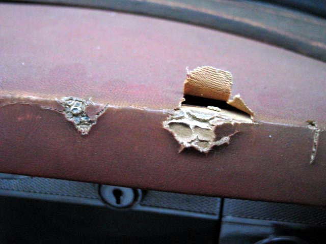

« Reply #3 on: July 05, 2008, 08:19:18 »
Hello Frank,
Here's a less-than-ideal photo!
The pad appears to be a strip of dense latex-like foam, dimensions 28 x 10mm, glued to the front of the aluminium dash panel. The top of the dash has a thin layer of lighter, more open textured foam, usually disintegrated to yellow powder by now. I have never seen either padding material sold by parts suppliers. I assume the upholstery shops have their own stock of suitable rubber and foam.

  • Posts: 4768
Re: How to get correct shape for 230SL dash retrim?
« Reply #4 on: July 05, 2008, 12:56:13 »
Frank,
here are some pictures of the dash padding.
If you still have the original wood and aluminum frames then you should be able to recreate the shape. The most difficult part will be the curve on the left. You can the see how it looks under the MB-Tex on the right side.
Good luck!
