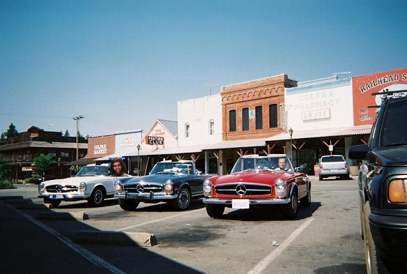

Here are the three side by side...
Ok I give up!  Which is which....?   :D

there's a lot of red white and blue going on....the same colours as in ...now what is it?

Originally posted by waqas
Quote
Caveman driving the 'old' 230.
[:p]

280 is in the middle with the later turn signals.
