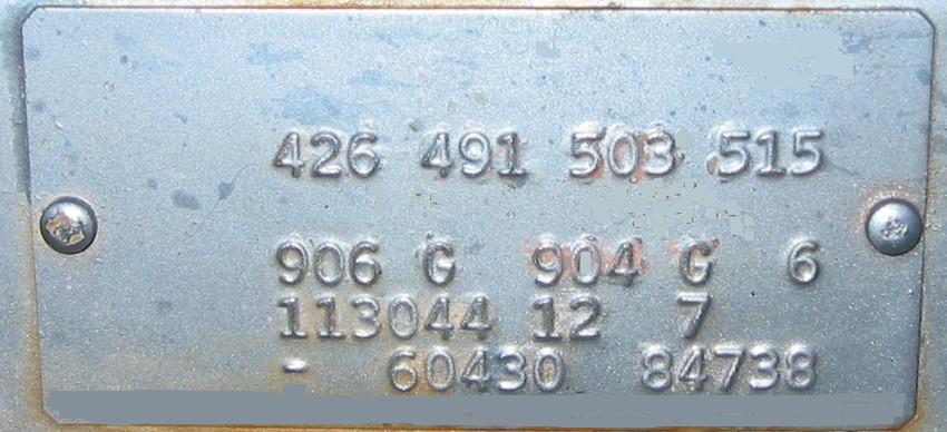

Or, does he mean this plate?
Download Attachment: BP4.jpg
58.8 KB
Mark280SL

« Reply #5 on: May 30, 2008, 06:59:17 »
Rodd, yes that is exactly it. Thank You for that image.
The image you attached (BP4.jpg) is the plate I'm talking about. It is also mentioned in writing in the thread wagas shared when you open that link.
The Photo that comes up at the top in the thread Wagas shared is something unrelated, it is a plate that Craig CAN produce, he does not produce the one I'm talking about and as far as I know no one does, hence my request for someone to send me the sizes of the letters and or a tracing.

Here's a mock-up of a data plate in jpg form.
Note the following.
It really doesn't matter whether steel or aluminum.  It gets painted.
Type font is typical, embossed block.  Anyone who does embossing on metal will have a very small selection, if any selection at all.
The plate measures 3.5 x 1.75, with rounded corners about .0625 radius. Font is 1/4" high.
Corners on the plate are only slightly rounded, much less so than on what is shown.
I can't decode the plate but for a few things; other here know what all the numbers mean.
First line: not a clue
Second line: body color 050, G for Glasurit paint.  Repetition of that is for the hard top.
113 044 12: 113 is the body style, 044 means 280SL, 12 means auto transmission.  My VIN ends in -7262, so the 7 might be the first part of that but the rest isn't there.
Last line, not a clue.
Location of type on the plate in relation to the plate is pretty accurate.
Download Attachment: dataplate.jpg
I thought the first line is the option codes.
From our tech manual
Line 1: The more important body-assembly related option codes.
In this example, 426, 491, 503, 515 (DataCard.OptionCodes). Early versions of the Body and Paint Number Plate underhood do not include this line 1.
Line 2: Color code body, paint supplier, color code hardtop and hub caps, paint supplier, hardtop code.
In this example, 906 Glasurit body color, and 904 Glasurit hardtop and hub cap color (Paint codes).
If a W113 was delivered without the optional hardtop, i.e. as Roadster, there were dashes at the location for the color code for the hardtop.
The 6 at the end of this line (the hardtop code) is the last digit of the code entered in code box 41 (here code 416, hardtop mounted, softtop folded). The possible codes are as follows:
- (dash) no hardtop was ordered
4 hardtop packed in separate crate, softtop on car
5 hardtop mounted on car, no softtop (but regular softtop compartment)
6 hardtop mounted on car, softtop folded
7 "California Coupe", hardtop, no softtop, no softtop compartment but rear bench
Line 3: Baumuster (first 8 digits of VIN) and distribution (Sales Market) code.
The distribution codes are described in Country Codes.
Line 4: Produktions-Nr. und Aufbau-Nr. / Production no. and body no.
In this example, the body no. is 84738, and the number 4738 is stamped into the hood, hardtop, softtop and transmission support.
Where the above sample shows a dash at the beginning of line 4, some cars have a 1 digit number or letter, presumably identifying additional body work for certain versions or options.

Michael, as always thank you.
John thanks for the info from the tech manual, I had seen that and  came up with what my plate should be EXCEPT for the distribution (sales market code) I must be thick but I can't figure out where on my data card it is listed, does anybody know if it is in box 42?
minus the distribution code for line 3 I need I think mine will look something like this:
551 426 491 503 515
670 H    670 H    6
11304412
    960640   03749
« Last Edit: June 06, 2008, 11:15:27 by Mark280SL »
Mark
Re: Data plate or else!
« Reply #21 on: June 06, 2008, 12:48:17 »
First line: 426 = Power Steering/automatic transmission   491= USA version   503=side view mirror,left
Second line: 568 H = Paint code UT/OT Signal red    568 H Hardtop  5=hardtop mounted
Third line: 113044 12 7  Chassis no (Fahrgestell-Nr.)
fourth line: -60506 = Production Nr.            ---86854 = Aufbau-Nr.
All numbers to match Data card
