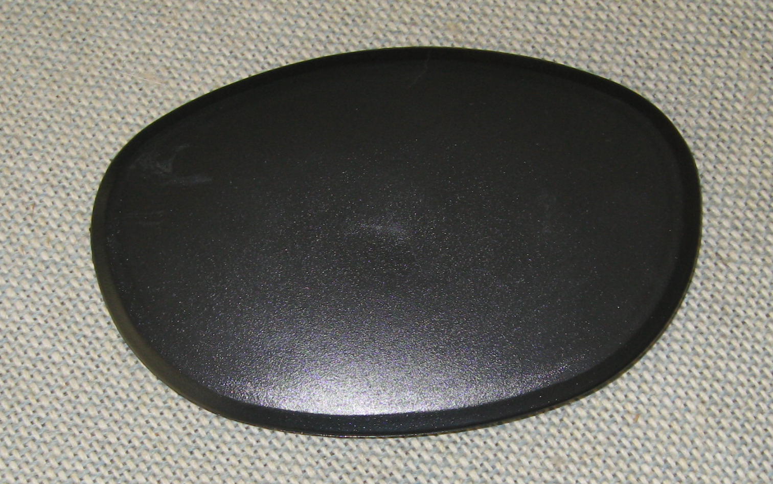

I'm confused about the subframe mount covers (see attached photo).  I bought a 250 SL very recently and it was missing one and the other was broken, so I bought 2 from the MB Classic Center @ $20 each - 15%.  I have seen new and used ones on eBay for more, but that's a different issue.
My confusion comes from having not seen these installed on other cars.  This includes 2 cars at the Mercedes Classic Center in California, as well as the $75,000 230 SL that is the subject of some criticism in a different thread.
Why do people not have this part installed on their cars?  My only guess is that someone decided it trapped water and served no purpose.  Comments?   thanks, Scott
Download Attachment: subframe mount cover.jpg
241.28 KB

Hi Scott. Not sure of the cut-off but they are an early 113 feature (possibly 230SL into early 250?). I have 'em.

The subframe covers are only original for earlier cars...280SL's did not come with mount covers as far as I know...not sure when they were eliminated.

I have them on a late model 250sl.

When I purchased my car they were already there so I have kept them in place.  I actually like the finished look as opposed to being uncovered.

Interesting thing about these covers is that I've never seen them in sedans of the era (although this is purely anecdotal). However, sedans had the rear shock mount plastic covers in the trunk, which the pagoda's never had. I've always thought of this as odd.

My early 250SL had them when I purchased it in '84 (from 2nd owner that had purchased it on a lease return a year after it sold originally).. and still has) them.... watch out you don't lose the clips though.

Fitted upto chassis 043 004189

Clips are available from MB, just bought 4 of them.

My 65 230 has them fitted from new

I have a 70 280 SL, I have one cover on the left side that looks old/original? and was thinking about getting one for the right side since it has none but if I understand what I read below maybe I should not because they don't belong on a later model 280 SL.
Am I understanding that correctly?

Yes, you are.
