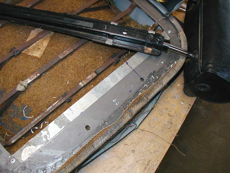

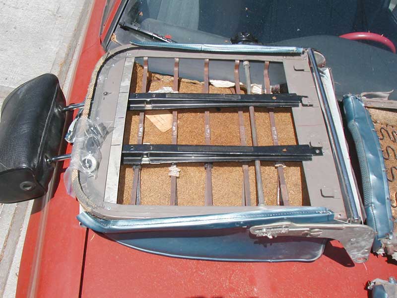

Near the top end of each  receiver ( or rail , as they are commonly called ) is a 10 mm  peg with a groove in it . The Mercedes design consisted of a keyhole slot in the sheet metal seat frame for the groove to engage as the peg slides down . No other retention method was used, other than the two sheet metal  screws at the lower ends .
The usual retrofit would require cutting narrow precision width slots in thin heat treated steel while it is oil-canning. This is not an easy task even for someone like me who has an FAA Airframe license. There IS a better way - -
Since the piece of sheet metal across the top of the seat back frame is too flimsy anyway,
I first pop-riveted on an aluminium doubler  plate (.035) to reinforce the area.

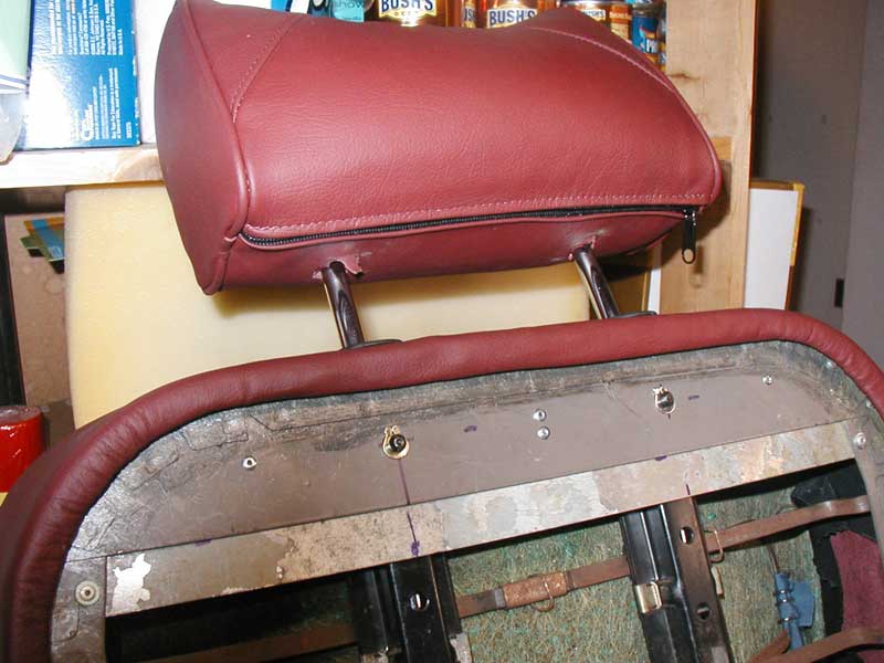

After a precise layout with the pieces assembled, I then drilled  two 10mm through holes.

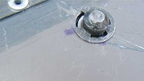

My method of attachment for the peg is to use an "e" clip. Before passing the peg up through the hole, I selected a thin grommet to shim up the height difference and  provide a  compressive type of fit for the e-clip to seat against.
An alternate method uses a crimp-able type retainer. The malleable C_clip from a brake shoe overhaul parts kit works quite handily.
The lower end of the rails is secured with s/m screws in the conventional M/B fashion.  My upholstery shop is handling the installation of the new leather seat covers.
My finished product photo shows the new back cushion, the Maroon leather, and the C_clip detail.
