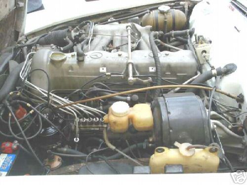

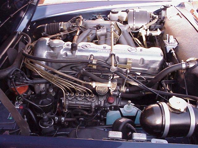

Here are windshield washer caps on two 113 cars.
One has a plain cap...the other has a cap with a fitting that has two connectors and a tiny "bottle top". Only one of the two connectors is being used.
Which of these caps is "correct"?
If the "bottle cap" is not for a 113 car, what model car is it for?
Richard M, NYC

Re: Washer Bottle Cap
« Reply #1 on: May 23, 2008, 20:12:12 »
Washercap2 is like the one on my car.  Can't say about the right hand drive one.
69280sl
  • USA, IL, Elk Grove
  • Posts: 575
« Reply #2 on: May 23, 2008, 23:54:04 »
My '68 has washercap2
Gus
Gus
« Reply #3 on: May 24, 2008, 01:43:45 »
"WasherCap2" is correct for the 113. "WasherCap" is from a sedan of the era.
