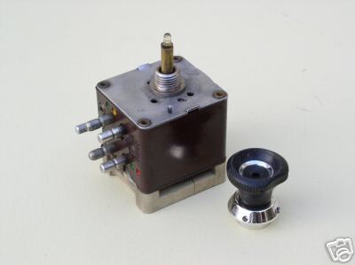

My 250 SL has a fan switch that works fine, but it's lose.  I have two assumedly easy questions:
1.  How do you get the knob off?  Pull hard?

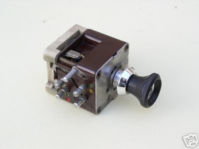

2.  Why doesn't my knob light up when on and lights are on?  If I look at the center of the knob, there appears to be a small dot as if it were something that would show light, but no light.  Even in the dark.
thanks!
Scott
Scott Allen
'67 250 SL (early)
Altadena, California
Re: Two fan control questions
« Reply #1 on: May 18, 2008, 13:34:54 »
Scoot,
1/ Loosen the chrome retaining nut:
2/ There's a bulb at the side of the switch:
