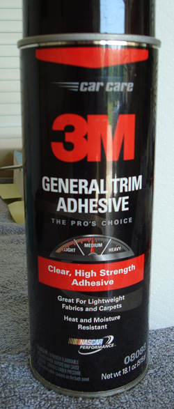

Is this the stuff?

Here's the stuff I used...
Bob  :)
