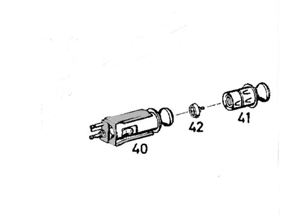

How is it removed? It is in the Wiki but...
I assume from the back but is it a complete dash job or can it be accessed from underneath? Once out, can they be cleaned/repaired?

The cigar lighter is pushed in from the outside of the opening in the dash.  There is a collar that holds it in place on the dash.  Behind the dash there is a u shaped bracket that is fitted to the cigar lighter.  The "u" ends of the bracket are forced up against the inside of the dash face and secured with a nut.  Here is a pic with the bracket shown in grey.  I think you can get to the back nut through the radio opening.
That's an interesting grommet. Do you have emergency flashers on your car?  That's the only thing I can think of that would go in that general area.
Download Attachment: cigar.jpg
