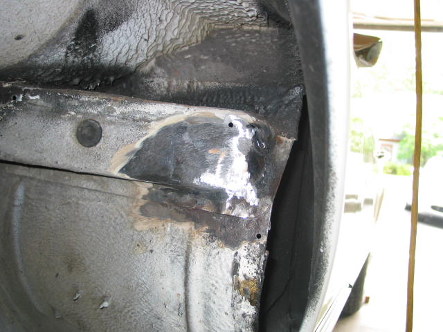

71, 280SL. This rust is located on the driver(left) side, upper firewall area. K&K does not make patch for this section.  The lower firewall is fine.  What would be your recommendation to repair this rust area?

Are you doing the work yourself?  Cut it out and fabricate a patch panel out of 20 gauge cold rolled steel.  It doesn't appear to be a difficult piece to make, in other words no compound curves or anything like that.  After making the piece butt weld it in place.  I can provide more details if you want.  Also consult www.metalmeet.com for a ton of information on anything metalworking.

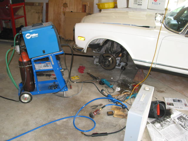

Yes I plan to do it myself.  I have a mig welder but I am not very good at welding.  I might go to the metalmeet event next week.  Thank you for the link.

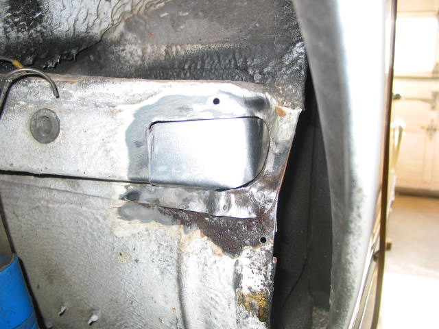

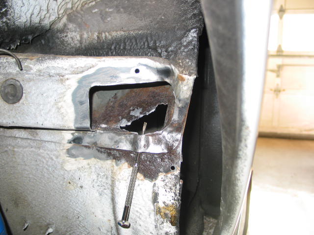

I cut out the rust section and made a patch from a 18 gauge steel.  I notice there is a drain (see screw driver) was clogged.  That must be the reason why this area is rusted.   Wondering where the water come in from?

Nice work.
I've seen this style of drain on almost every box/frame section in this car (and my '66 250se/cp). I would strongly suggest you checkout the air intake area (which sits directly above the center of this frame section). Also, there are metal drain pipes that drain out through the lower firewall, via some short rubber hoses  (can be seen from below the dash).

I had corrosion in the exact same area, and I didn't notice the drain. I am not sure if it will allow the spray from the wheel to force water up into the cavity, more than function as a drain hole  :?:
"BTW. How do you treat the inside area before I weld the area shut? Por-15? undercoating?"
I'm not sure if there is much point in treating before you weld. The coating will tend to burn. I sprayed plenty of anti coorosion treatment into the section after welding. The hole plugged by a grommet (seen in both your photos) is there for just that purpose, I believe.

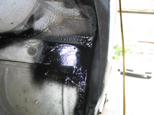

How did you treat the inner panel?

I am going to spray undercoating from the hole plugged by the grommet later.
