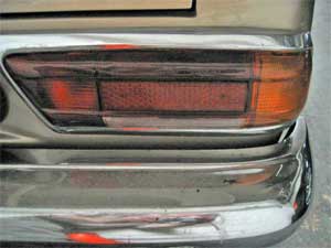

The production schedule (supposedly reliable) indicates that the 230SL with VIN ending 9057 was produced in February 1965. It took some cars quite a long time until they were sold. (My previous car was sold about seven months after production). The Data Card should have the production date stamped on it.
The tail light situation is (to me) quite confusing. There were so called "all red" lights, lights with narrow center sections, lights with wide center sections, and maybe more.
Not sure which style lights are correct for the various models, years, and markets. The Tech Manual has some comments on this at
http://www.sl113.org/wiki/pmwiki.php?n=Electrical.TailLights
Here are photos of two light styles:
The first photo is the light on my 1969 Italian market car. I'm not sure if the light is original to the car. The light is what I call a "Wide Center" style light.
Download Attachment: RearLight69sml.jpg
10.33 KB
The second photo is a "Narrow Center" style light. The light in the photo was on a 1970 280SL but I've seen the "Narrow Center" style light on a 250SL and a 1964 230SL.
Download Attachment: RearLight71sml.jpg
7.52 KB
The problem with tail light identification is that these lights are easily broken and often replaced making it difficult to pin down original styles of lights for various cars.

The date stamped on your datacard is not the production date but the delivery date. My 114015 was 1st registered in Germany on 14 Sep 1971 and datacard says 15 Sep 1971. OK, what does that mean? That the car was already around produced on 13 Sep (and most likely sooner), registered on 14th and handed down to my uncle by the local DaimlerChrysler agent (Patberg & Co. in Lengerich, Germany) on 15th.
Most likely Richard is correct. Yours was built earlier (1965) and delivered in 1966.
As to your rearview mirrors.
I don't know about Australian cars but perhaps these came usually without rearview mirrors (like French cars) and your 280 SL mirrors were added afterwards. Of course the preowners had to drill holes for that and that is what you found out at your painter's shop. Please what does the data card say? Does it have any 50/x option code?
Now Richard. 8)
Please, where was your car originally sold? What does the order line of your datacard read? 85xx yyyy? That's what I suggest. Ordered in 1968, delivered to Europa, perhaps Italy. Your taillights seem to be original to me if your car is older than serial no. 007397. All 280ies up to that serial had red taillights (including 230 &  250ies).
Red taillights means all-red-taillights, i.e. "wider center" ones.
But there are 2 exemptions, and you have one of these.
Cars for France: back-up light not clear but orange (amber) (rest = red)
and
cars for Australia and Italy (and I "believe" also from a certain date on to Britain - but the British know this better): turn-signal orange (amber) and rest like every ordinary red taillight.
Thus, your taillights on your "69" should be original. The change was with serial 007397 and 007398 in February 1969. Thus, your car is most likely a genuine 1968...

My option code of 619 states that the rear turn signal was orange ! So like Richards, I have the all-red-amber-turn-signal combo (in fact this was for UK/Aussie/Italian cars)
