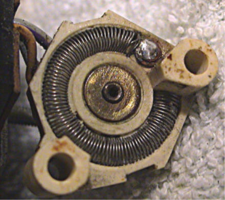

Re: Dash board lights
« Reply #12 on: May 14, 2008, 06:31:39 »
Jim,
My rheostat spring was broken very near its end.  I was able to solder the end and it works well.
Download Attachment: Rheostat.JPG
43.22 KB

James Stern
« Reply #14 on: May 14, 2008, 12:17:16 »
Jeffc,
Thanks for the .jpg.  If I don't sell it (will know in a couple of weeks) I will take your and Naj's recommendation and first take it apart and try and clean it and if that doesn't work I will shoot it.
