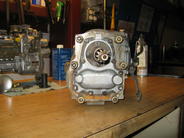

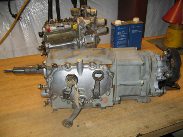

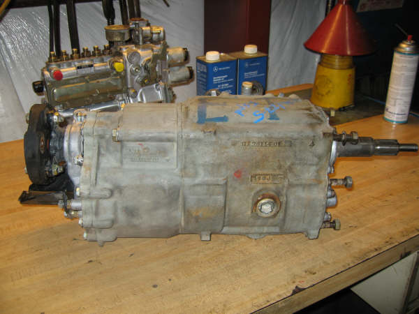

The "Original Mercedes SL Restorers Guide" by Laurence Meredith at page 89 mentioned that the ZF 5 speed gear box was replaced with the MB G 76/27-5 five speed in May 1969 as an option.
The following photos are of that gear box that Gary kindly sent me of that model transmission.
Download Attachment: Gear box 5 speed USA.jpg
41.74 KB
Download Attachment: IMG_0503.jpg
39.56 KB
Download Attachment: IMG_0506.jpg
39.98 KB
Can anyone confirm that it can be relatively easily adapted to fit the 280SL?

mbzse
  • Posts: 1748
Re: W114 Gear Box
« Reply #5 on: April 21, 2008, 08:22:58 »
Originally posted by Garry
The "Original Mercedes SL Restorers Guide" by Laurence Meredith at page 89 mentioned...
This book is notoriously unreliable.
Thus, do not trust what is written in it. We have counted there to be at least one false statement on each page of this Meredith W113 book...   ;)
/Hans in Sweden
(PS: The G76/27-5 was never factory fitted to any W113 car   DS)

Garry,
Do a little search here on the site.
Commonly the Getrag 5-speed gear box is not usable for the 113, at least not easily.
Only the ZF was the only 5-speed option for our SLs.
However, our member Hauser here got his 280 SL converted with a 5-speed coming from a 108 or so.
I think to remember it was quite a bit of conversion work of his restorattion shop to get that Getrag under the tunnel of his marvelous 280 without destroying anything else what remained original.
I don't know whether the 108 5-speeds and the ones from the W114 are the same.
