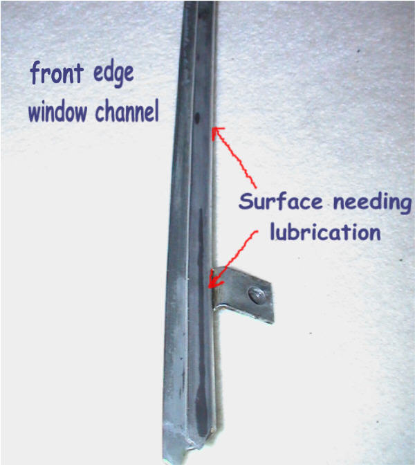

Finally decided to remove the felt window channel inserts I installed last year in the driver door. I'm going back to the aluminum slide jaws that attach to the window.  With the felt strips movement was good up and down but at the full extension up the window was not supported very well at all by the felt channel.  I could not get a reliable fit with the weather stripping.

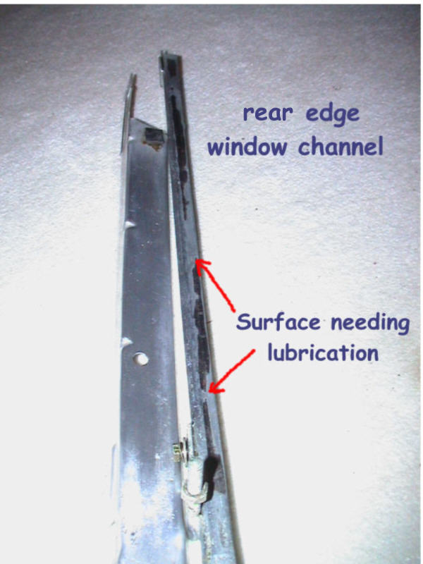

As I took a good look at the window channel after cleaning out the glue I used to secure the felt I noticed two edges of the channel that over the years had been very lacking in lubrication.  These edges have scoring marks where the plastic slides inside the aluminum jaws ride up and down.
I thought I would post some pics of the channels so that the next time you have your doors apart you can lubricate the right edge versus slathering the area with grease.  The pictures clearly show the area of friction.
Let me know if the explanation on the picture is clear enough to locate the edge on your car.
Download Attachment: window grease.JPG

Download Attachment: window grease1.JPG

Michael,
My problem in the past has been the aluminum jaws falling off the window.  I suppose there are two problems contributing to this.  Slide friction and jaw adhesion to the window.  I'm trying to address both issues this time around.  I think I understand where to lubricate and I'm trying JB Weld epoxy to secure the slide jaw to the window.  Looks good so far.  I'll put the window back in place later today and I'll know more after a couple of months of usage.
