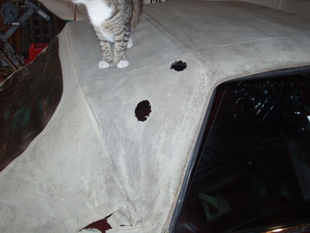

I thought that I was the only one that had mice!!!  This is what my soft top looked like when I bought it from the previous owner - who kept the car outside.  On top of the roof you'll see my 'mice avoidence device' - it seems to work very well.
Doug

If you have a concrete floor, put down the plastic anyway.  You'll be surprised how much moisture leaches up through several inches of "solid" concrete in any kind of even mildly damp climate, especially in winter.  Put the plastic down and check it periodically - you'll find condensation under the plastic.  That condensation was formerly attacking your undercarriage, engine bay, and exhaust system.
When you store the car for the winter, put the top up.  It keeps it stretched out and wrinkle free, and helps preserve the shape of the "lip" at the base of the top.  Rodents rarely gnaw on an erected top - they like the ones that are stowed away in dry dark  undisturbed places that they can nest in (see Doug's picture!).
