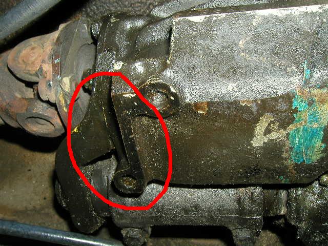

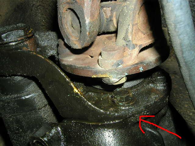

My rear differential has a leak.  I guess it's about a drip a day if that. Can anybody help with suggestions on how to fix this?  Is it a DIY job or too much of a pain in the butt?  I have no idea what is entailed.
I have attached some pictures where I see the drips coming from.  It seems mostly from where the drive shaft connects to the differential.
Any help would be appreciated.

It is usually the rear pinion seal. More of a eyesore than a problem. Replacement requires disconnecting the drive shaft at the rear. A special spanner socket is required to remove the slotted nut. There is some procedure which must be followed for re-installing the nut. You will need to mark the position or install a new "crush sleeve" and toque to specs. The seal is easily replaced the housing it mounts in can be removed with the seal enabling the change to be done on the workbench or everything can be done under the car with the housing in place. There is a lot of information already in the posts on changing differentials.
This leak is common, and rarily gets bad enough to cause much concern. If the mess on the garage floor bothers you, replace the seal it is inexpensive. Otherwise check you axle oil level a couple times a year. You will find that it really does not loose much.

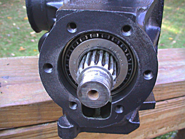

Here is what you need.
Download Attachment: pinion 1.jpg
67.14 KB
Download Attachment: pinion 2.jpg
74.67 KB
Download Attachment: pinion 3.jpg
29.12 KB

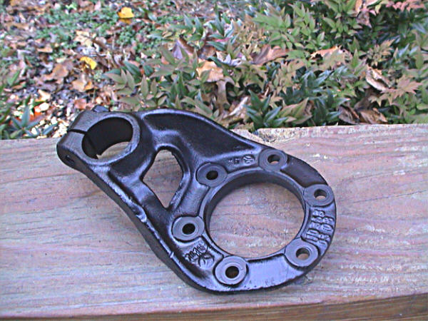

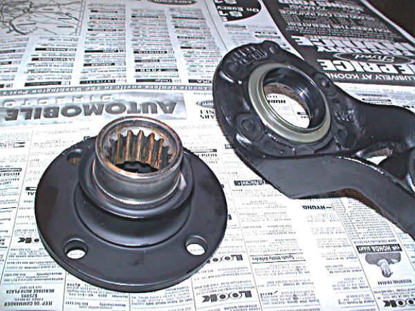

Here are some pics of the components.
Download Attachment: mrfat1.JPG
68.24 KB
Re: Leaky Rear Differential
« Reply #5 on: March 26, 2008, 12:09:42 »
Download Attachment: mrfat2.JPG
86.82 KB
« Reply #6 on: March 26, 2008, 12:11:21 »
When doing this job you should replace the oil seal and paper gasket.
Download Attachment: mrfat3.JPG
88.4 KB
« Reply #8 on: March 26, 2008, 14:35:14 »
You're welcome.  Yes I have done this job before with the axle removed.  I think others have done this job with the axle still mounted. Ask away if you have more questions.
