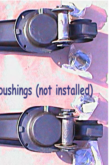

I am in the process of putting my rear axle back together again and have a question....
Which way do the rear lower spring cups sit?  Does the adjustment marking "1 2 3" point towards the front of the car  :oops: ?
Same position for both left & right sides?
Thanks for your help!
Bob :)

I will have to check, however I believe the 1,2,3 were to the rear,
99% sure
note: you should put these back in adjusted the way they came out.

Hi Bob,
Hope this pics helps.
Download Attachment: Bob Spring.JPG
67.35 KB
Re: Rear Springs - Lower Cup Position?
« Reply #4 on: March 26, 2008, 16:55:48 »
Hello Jeff!
Yes, thank you!  Your pic shows that the "1 2 3" needs to point towards the front of the car.
Thanks again!
