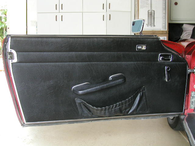

My left side door panel is discolored (see attached pic).  I must have used something that I shouldn't however nothing else is discolored in the car.
I have tried all sorts of cleaners but nothing seems to work.  When I first apply a "product", the "wet look" looks great then it dry like the picture.  It seems that the indentations of the vinyl are discolor white.
Any ideas how to fix this or what product I could use?  Can I wipe on a black dye or something?

There are vinyl paints out there that are supoosed to work well in situations like yours.  I don't think dye is the way to go with vinyl.

I've seen dyes for touching up MB-tex on World Upholstery's website.

I just used a product called "black magic". It's a heavy silcon used for dashboards, rubber mats, rubber bumpers, tires, etc.
It seemed to do the job so far.

This would be a piece of cake for a water-based dye. You could even apply it with a brush as it is self-leveling. The only problem is you'd have to do the entire interior because it will end up being so dark that it will stand out.

Looks like your door panel may have been a victim of Armorall.

I think that you are right about the armorall.  I stopped using it awhile back but I know that I had to use it on the whole interior. Why would it be only that door that got damaged? Are you not supposed to use Armorall on MB Tex? Is Armorall bad?  I stopped using it because I didn't like how it always collected dust.

I suggest you take both panels off and spray them with vinyl paint from World Upholstery, about $18 per spray can. Since you have black, it is probably a stock color, if not they will match a sample swatch for an additional charge.
I used it to change the color of used panels I bought (from cognac to beige) and was very satisfied.

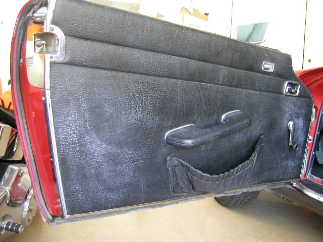

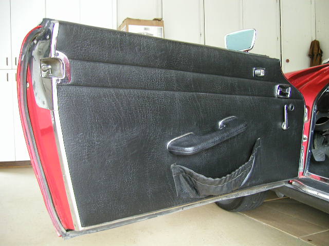

Here is my result of the "black magic' product.  I had it laying around in my garage and thought I would try it.
Download Attachment: P1010026.JPG
61.38 KB
Download Attachment: P1010027.JPG
66.74 KB

  • Posts: 1811
Re: Inside door panel discolored
« Reply #10 on: March 19, 2008, 14:35:38 »
Looks like you may have hit on a reasonable fix.  If it still looks good in a month or so, or after sitting out in the sun with the top down a few times, you've probably got it licked!
Does it leave any residue that might rub off on light colored clothing?

« Reply #12 on: March 19, 2008, 16:19:36 »
I was wondering if there was going to be any residue but there isn't any  :D   Right after I applied it the vinyl was dry.  I also checked the next day and it was dry. So far everything is back to normal.

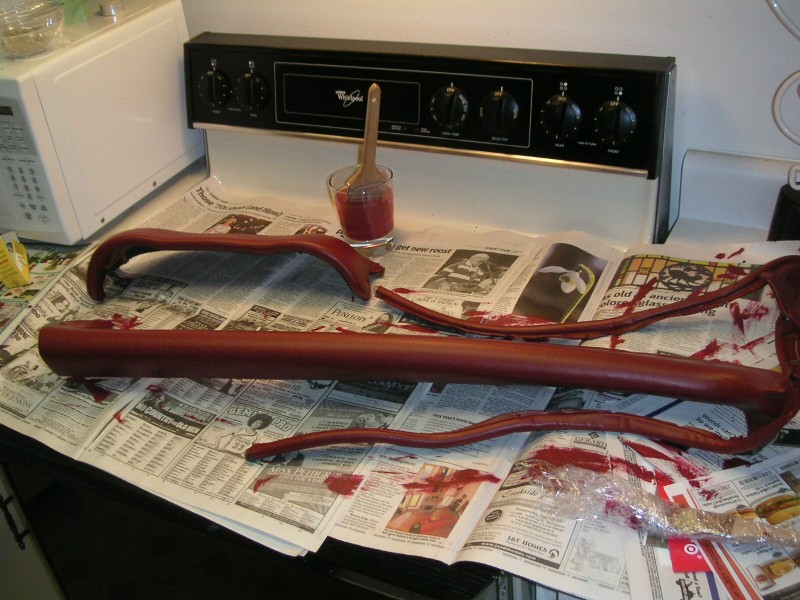

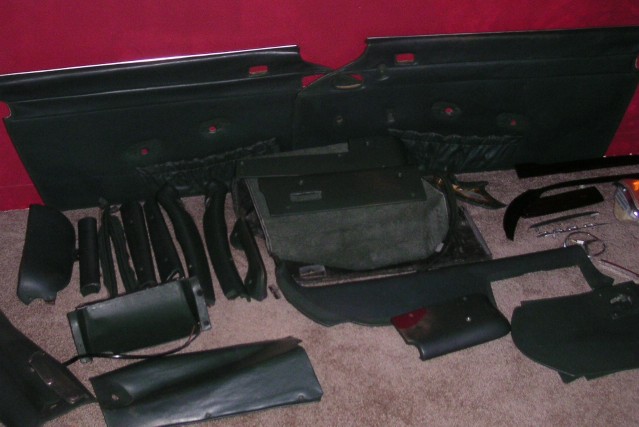

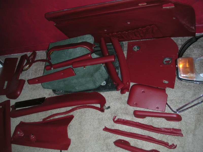

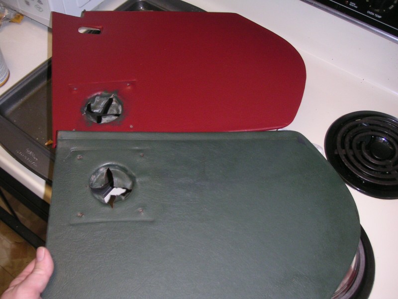

« Reply #13 on: March 19, 2008, 17:07:17 »

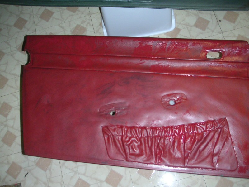

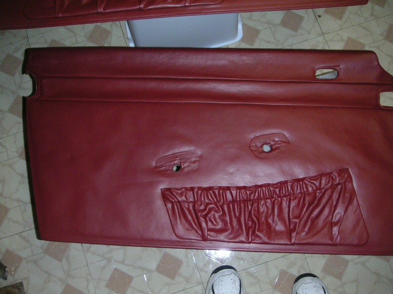

So I have used Color-Plus for about 15 years now. I have no affiliation to them...but Joanne has been great...she can match any color...I just redyed my Leather/vinyl interior on my 1971 280SL from green to red.. as you can see it took 2-3 coats, but came out great and it really lasts.  I used on a 850i BMW 4 years ago and still looks like new.  I can help with instructions if needed or post to the board.
Her # 1-570-686-3158.
Hope this helps
« Reply #14 on: March 19, 2008, 18:20:46 »
I find this whole Armorall thing kind of troubling. I have used it on my vinyl in years past I think -- fortunately without any bad experiences. I do recall someone telling me it was dangerous for hard dash plastic, like what my 80's Honda Accord had ...
I have also used Son of Gun? on my car -- In recent years, I have relied on Meguire's Shine. I don't go overboard because I hate the greasy look but this stuff seems to condition the MB-Tex nicely.

@Baron,
Wow, that is amazing.  The #4 picture scared the heck out of me though [:0] until I saw #5.  How does that paint hold up?  Will it crack and flake after awhile?  That is one radical change you made  :)

« Reply #16 on: March 21, 2008, 00:13:44 »
I have used it on alot of cars...the only trouble I have had is if it gets wet again within a month...Then, where it was wet the dye eventually wears off (approx 2 months) So I always let it sit for a few weeks before getting sweat/water etc on it.  As for flaking as long as you prep it correctly...no problem.  The prep is the key, the leather and or vinyl must be pourous and ready to take dye.  Check out the Color-Plus website for some great advice...Bob
