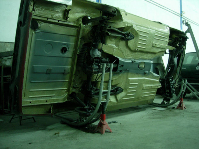

On this car there's definitively black paint on the actual rockers, car under the black panels. I do  find it hard to believe that someone actually took off the black panels, and sprayed the rockers before installing the panels again. But one can of course never be sure when it comes to a car that's almost 37 years old.
I realized a bit late that I probably made a mistake when I painted the underside of the car in the to be exterior color. I believe it's only a slight over spray of the exterior paint that found it's way to the edges of the floor pans etc. AT least the mid-section is correct in Grey primer, although I freshened it up a bit.
This car was light beige(181), a color that looks a lot like the color of the factory undercoating, so that's what led me to believe it was painted that way. The reinforcement under the drive shaft is uncovered(no undercoating or paint) and shows the Grey factory primer.
The picture below shows it after it was painted, but the rockers still needs to be painted black, that is if my assumptions are correct.
In my opinion it makes sense that if they decided to paint the rocker panels black to give the car a slimmer appearance, they would not then leave a small stripe under the rocker panels in the exterior color, which could be viewed from the side. Thanks for all the comments.

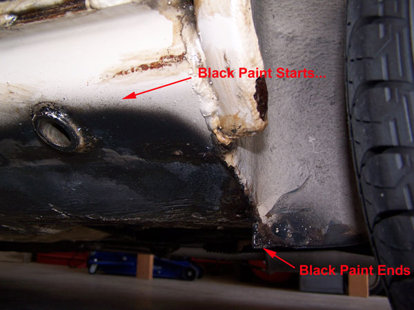

Hello Hans,

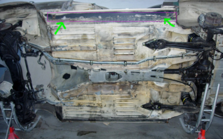

Your underside looks great!  A couple of years ago, I removed my rockers to clean underneath and to also have them repainted.  Here is a pic I took with the rockers removed.  It shows black paint sprayed on, starting about at the jack hole level and ending just at the lower edge of the side (lower area still visable when looking at the side of the car.  The direct underside is body color...)
As I am in the process of having my 113 repainted, I have debated on whether or not to recreate the center underside area in the primer color, as you did.  In my case, I decided to have the entire underside redone in primer, undercoating, then body color. So my center will look the same as the rest of the underside.  Of course, the rocker areas black, as original.
Can anyone speak to why MB would have left the trans tunnel area and driveshaft area in primer vs undercoat and paint when it went down the line?

Hi Bob,
Thanks for the picture that shows the black rocker areas, it looks exactly like on my car.
My guess regarding the unpainted tunnel area is that it was not deemed necessary to undercoat and paint it, due to the minimal exposure to the elements that this area has to endure, also to paint the underside  could have been skipped for production and or cost reasons.

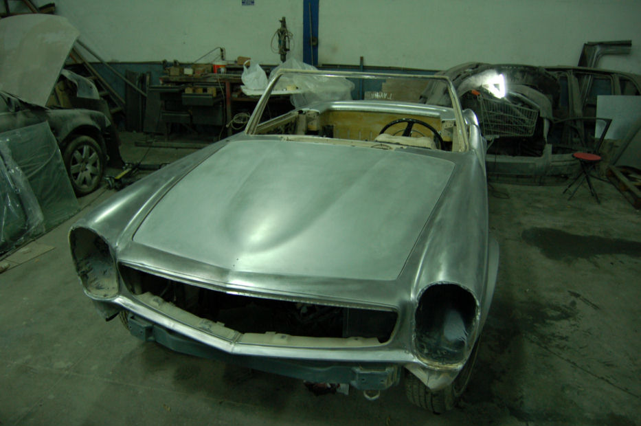

Here's a picture after most of the paint was removed(not something I look forward to do again) on the car. It looks like
we're at the approximately same stage in the process, although I suspect looking at the progress you are making according to your restoration report, that I will soon be far behind if not already.

Hi,
Paint was removed mostly mechanically by using a grinder(Festool) w/ 100p/80p. Some areas I used a hot air pistol and a spatula to remove the outer layers of paint/primer before grinding the rest to the metal. And some minor oxidized spots(around the clip/screw holes) where sandblasted with a spot blaster. Inside of hood was chemically stripped w a paint remover.
