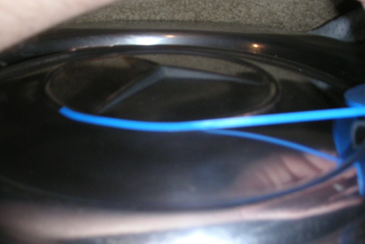

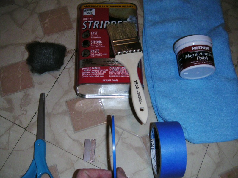

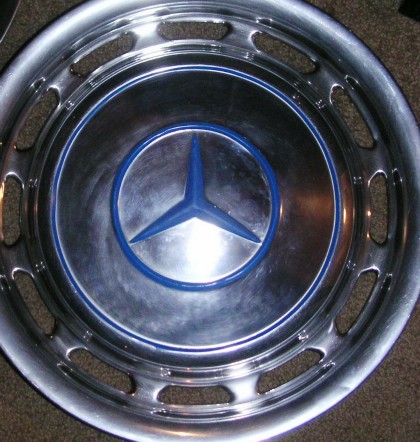

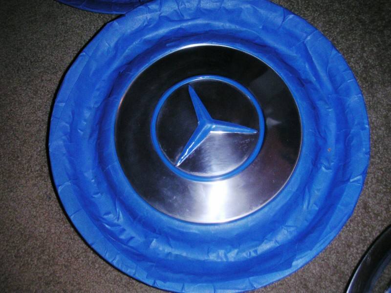

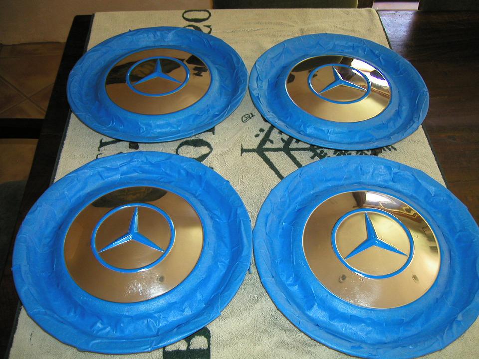

So, everyone has been so helpful to me I am trying to give something back.  I recently posted that to save money, and ensure a good job I was going to prep my hubcaps (1971 280SL) myself.  I am posting some pix and some instructions on how I did it in no way am I saying this is the best way or advocating anyone to do it this way(good legal disclaimer)
Supplies needed Picture #1 Supplies
1. I cannot stress how important prep is on this. To begin with I used Kleen Strip strip X stripper on the painted sections. (available at Home Depot $9.00) I have used this before on fiberglass you brush it on, the heavier the better but only brush on once...wait until it is bubbling then wipe off with a paper towel.  Sometimes you have to put on a second coat on the stubborn parts, also if it can't bite the surface used a little XXXX steel wool (that is 4x steel wool)
2. I then polished the whole rim with Mothers Mag/Aluminium polish.  When you are done, and it takes awhile it should look like chrome.  If there is any residue from the stripper or road grime you can use the xxxx steel wool.  But when you are done there should be no residual ANYTHING on the rim. See picture # rim5
3. I them go other the entire rim with a little laquer thinner to remove all the wax.  I know we just put a fine layer on, but that was to look for inperfections.
4. Then after it is dry use the 1/4 " tape ( which can only be purchased from a body shop 3M and about $8.00 per roll...you just need 1) to tape the inner ridges, I found it worked best if I had it on its side.  use one hand for guidance.  If done correctly the inner ring should have a 1/16" gap between the two pieces of tape.  Then you use a third piece to cover this. NEVER use the razor blade directly on the rim always lift and cut. See picure #rim0
5. To do the stars I cut the tape first and then went from the point inward.  After finishing I then used Painters Tape available at Home Depot to cover the rest of the rim. See picture rim#1,#2,#3,#4
I hope this has been helpful

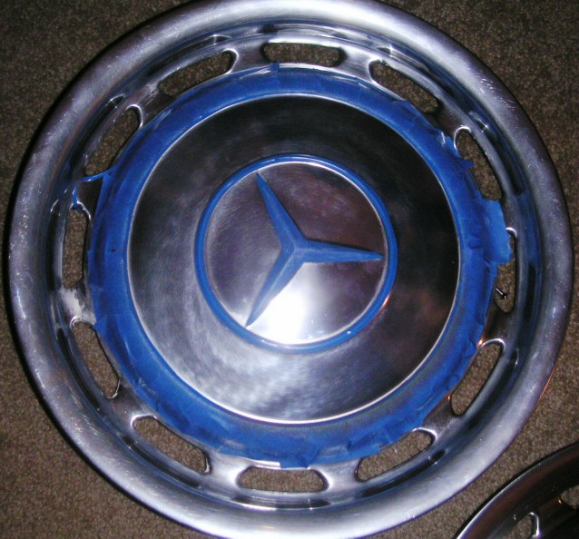

I'm in the process of taping up my hubcaps now.  I have 2 of them done.  It does take awhile. The stars are the hardest part.
I did follow this thread and bought the 1/4" 3m tape.  However, if I'm reading the thread right the 1/4" would be too big for the inner ring. It wraps up and over the inner ring leaving still a small space to be taped.  I made it work with the 1/4" but I think 1/8" would work better if you follow Baron's instructions for the inner ring.
I am going to paint one hubcap tomorrow and see how it goes.  The one thing I'm not sure of is how long do you wait until after the final clear coat do you take off the tape?
Anybody have an idea?

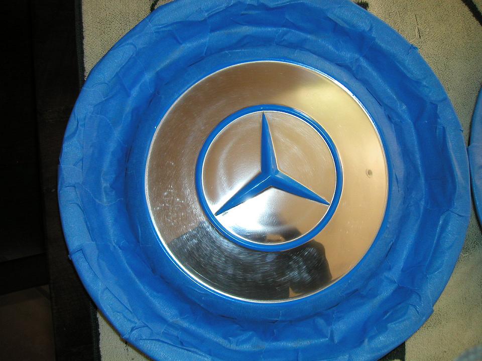

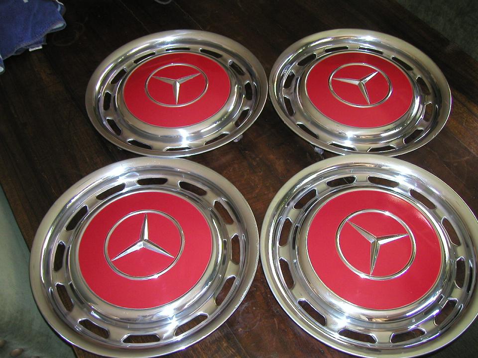

Here are my results as promised.  I think they came out rather well considering I have never done this before.  However, I got some great tips from this forum.
Supplies:
1/4" 3m Blue Vinyl tape (auto paint store)
2" 3m Blue painters tape (Home Depot)
Mothers Mag/Aluminum Polish
Laquer/paint Thinner
Dishwashing soap
9'x 12' paints plastic drop cloth
1 Spray Can of Primer
1 Spray Can of Paint
1 Spray Can of Clearcoat
I got my paint supplies from http://www.automotivetouchup.com/.  I think the price was around $45.
Process:
Step 1: Cleaning
- Jet wash clean of brake dust and grime.
- Remove old paint. (mine were bare metal to begin with)
- Polish with Mother's Mag
- Wipe down with Laquer Thinner
- Wash & Rinse with Dishwashing soap (degreaser)
Step 2: Masking
- Mask outer ring using 1/4" 3m vinyl tape. Start on the inside and fold up and over the outer ring.
- Mask inner ring using 1/4" 3m-vinyl tape
    Method 1) Use 1/4" tape for entire inner ring.  I taped up and over.  It seemed to fit perfectly.
    Method 2) If you wanted to tape more of the ring (not sure if necessary at all. You are talking about 1/16" if anything)you could put down 2 1/4" tapes. First, tape the inside of the inner ring and fold up and over. Second, tape the outside inner ring and fold up and over so they over lap.
- Use 1/4" 3m Blue vinyl tape to cover stars.  Start at the points.  On a ~3" piece of tape I cut an angle on the last 1/2" of the tape. I used that to start at the point and tape up to the center star. This only covered half of the star point.  I did the same thing for the other side of the point. Repeat 2 more times for the other 2 points and then cover the rest.  Basically use any method that you feel comfortable with.
- Using the 2" Blue painters tape cover the rest of the hubcap
I used both Method 1 & 2 on two hubcaps each.  I could not tell any difference. Each Hubcap took me 45 minutes to do.  That included several redo's to make sure the tape was put on straight.  It does get easier but it can be difficult to see exactly where to mask.
Step 3: Paint
- set up a mini paint booth using the 9x12 drop cloth.  I just set up on the garage floor and created a canopy that would fit the 4 hubcaps.
- Make sure all hubcaps are completely clean.
- Spray 4-5 light coats of Primer 10-15 minutes apart or dry to touch.
- Spray 4-5 light coats of Paint 10-15 minutes apart or dry to touch.
- Spray 4-5 light coats of Clearcoat 10-15 minutes apart or dry to touch.
- Let dry 24 hours
I actually put on about 7-8 each on the advice of the guy that sold me the paint. However, there were a couple of spots where I thought the paint was too thick and made removing the tap tough but not impossible.
These hubcaps are the new stainless steel ones.  I bought them on Ebay for $15 each.  My originals are the older chrome steel parts. Some day I will remove the old paint and repaint them also.
