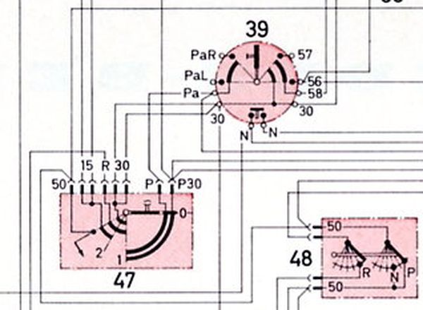

Jeff, The mechanical part of the switch(not the separate electrical part) might be the problem.  It comes out by itself.  These fail after many turns!
Re: Ignition w113
« Reply #7 on: February 24, 2008, 19:06:03 »
Glen,
True enough.  Do you have any docs that could help Jasper?
Re: Ignition w113
« Reply #8 on: February 24, 2008, 19:28:27 »
Jeff, Working on a ladder kind of diagram that is easier to follow, in a decent form.

Jasper,
#47 is the Ignition Switch
