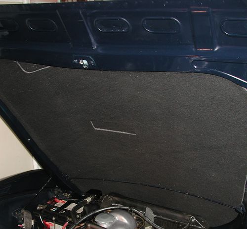

Here's one from a pad from a W107:
paulr
Re: soundproofed bonnet/hood
« Reply #4 on: February 17, 2008, 11:36:27 »
thanks NAJ. Is it effective? It certainly looks OK. Was there a lot of cutting to do? How about heat given that it isn't foiled?
paulr
lovely 1970 280 SL
« Reply #5 on: February 17, 2008, 15:18:03 »
paulr
lovely 1970 280 SL
I made a newspaper template to cut the mat to size. It is used like this on the 107. It is a lot quieter now and I haven't noticed amy temp. rises but it has not been that hot since I installed it. I decided to do it while I had the bonnet off to change the oil cooler.

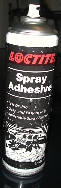

For Naj
what did you use to secure the 107 pad to the hood? I have ordered one today from SLS.
paulr
lovely 1970 280 SL

update
The r107 soundproofing bonnet material is in and I'm not convinced it's made much difference, at least on it's own. I have ordered some "boom mat" for the interior which I will fit..sometime..which together with the hood may help. To be honest now that I have done the axle converstion it may all come together to have the desired effect.
