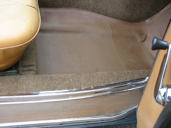

« Reply #8 on: October 16, 2003, 19:19:01 »
Achim,
My brown rubber floor mats (with 113 part number) and brown rubber door sills match in color.
Download Attachment: mat matches door sill.jpg
66.78 KB
I assume that all W113 cars had matching rubber mats and door sills.  Is this wrong?

« Reply #10 on: June 25, 2004, 15:30:19 »
My '66 230SL has the same color door sill rubber strips as shown in your picture.  I am told that that replacements in that color are no longer available.
Originally posted by rwmastel
Achim,
66.78 KB
