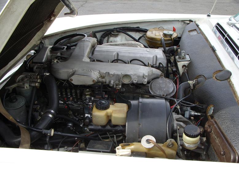

At the recent MBCA Peactree meet there was a 230SL that had been modifed with a deisel
Download Attachment: Buds Benz 08 003.JPG

I bet Walt Klatt did not know he had any competition in this arena. I assume this is not his car, since it has a Georgia plate...

I think Walt's car is a four cylinder Diesel out of a 220D. this one is a six cylinder Turbo-Diesel, probably out of a W124 300D 2.5. If so the owner could probably legitimately rename it a 250SL Turbo Diesel, if he could find a 250SL badge to replace the 230SL emblem on the bootlid.  That would certainly confound the originality police!

I never did find the owner...I was too busy picking the brains of George Murphy our feachered speaker and David Latham our host. All things considered maybe it is the Mechanical Engineer in me but there is nothing that matches the aethetics of the fuel lines wraped around the front of the Mercedes Benz 113 engine. I plan to keep mine as is

Thanks Mike, my car actually has a 190D 2.2L diesel with a 5 speed in it.
Hauser: It's a lot of sweat and thinking to get this conversion to work, becoming green is what I like and strive to mimic the ease of not becoming frantic after every 300 miles or so in search of a gas station.  This one should give me about 600 out of the tankful. I've had a 1968 280SL #618 before, and it was awful at the pump.

Seems to be stick shift, I cannot find a dipstick for the automatic transmission on the pics.
Like the idea of a 6 cylinder Diesel in the SLs engine bay since our cars have 6 cylinders too.  :) Can't see all the intake ports and fuel lines but the head looks long - so 6 cylinder. Thus, Mike, it must be a W124 300D 3.0 instead of 2.5 (which is a 5-cylinder). Therefore, the owner "had to/should get" a 300 SL badge instead of 250 SL.[:0]

My ignorance is revealed! [:0] I have a 1986 Euro model non-turbo W124 300D.  It is a six cylinder.  The Euro owner's manual covers three different Diesel versions including a 2.5L model that seemed to be a smaller displacement version of my 3.0L six, at least in the diagrams.  The smallest displacement model was a four.  I have seen later model W124 300D 2.5 Turbos on the road and always assumed that they were that same six, boosted.  A 300SL trunk emblem should be a little easier to find, since there was such a model produced in the '90s.
