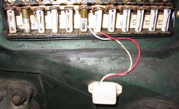

I too had problems forgetting to turn off my lights and draining the battery, so purchased an inexpensive warning buzzer from the canadian equivalent of Pep Boys (Canadian Tire). It came with simple mounting instructions and I ended up mounting it just below the fuse box on the firewall with the provided double sided tape. Ran the wires into the fuse panel and directly to the fuse holder(NO.6&7 I believe). Wrapped the bare wires around the fuse holders and popped the cover back on to try it. Two years later and I still haven't bothered making a better connection. Nothing permanent, no screw holes and because it was rather loud, I'm glad to have it under the hood rather than the cockpit. Saves on those embarassing moments outside a fancy restaurant when you have to ask someone if they could give your wife a hand pushing the car to pop start it. :(

Download Attachment: light warning buzzer.jpg

« Reply #3 on: October 05, 2003, 07:46:34 »
Ricardo,
Thanks!  The picture is a huge help.  This sounds like a simple winter project for next month.

Anybody know where to get those short stubby fuses (see buzzer picture)?
I did find a part number for it but that is now a bolt[:(!]
