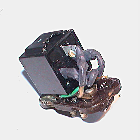

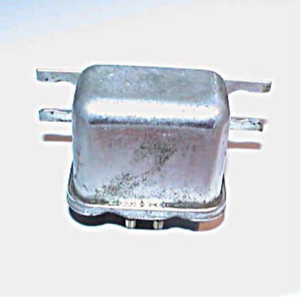

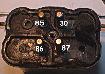

Here are some pics of my relay.  The wiring is very simple.  lugs on the old and new relay are labeled as 30,85,86 and 87.  Just solder 4 short jumper wires and recrimp the box and you're finished.

Re: Cold Start Relay shocker
« Reply #9 on: January 09, 2008, 14:23:01 »

Neat Job!!!
