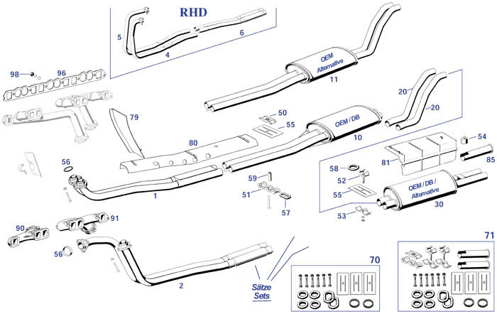

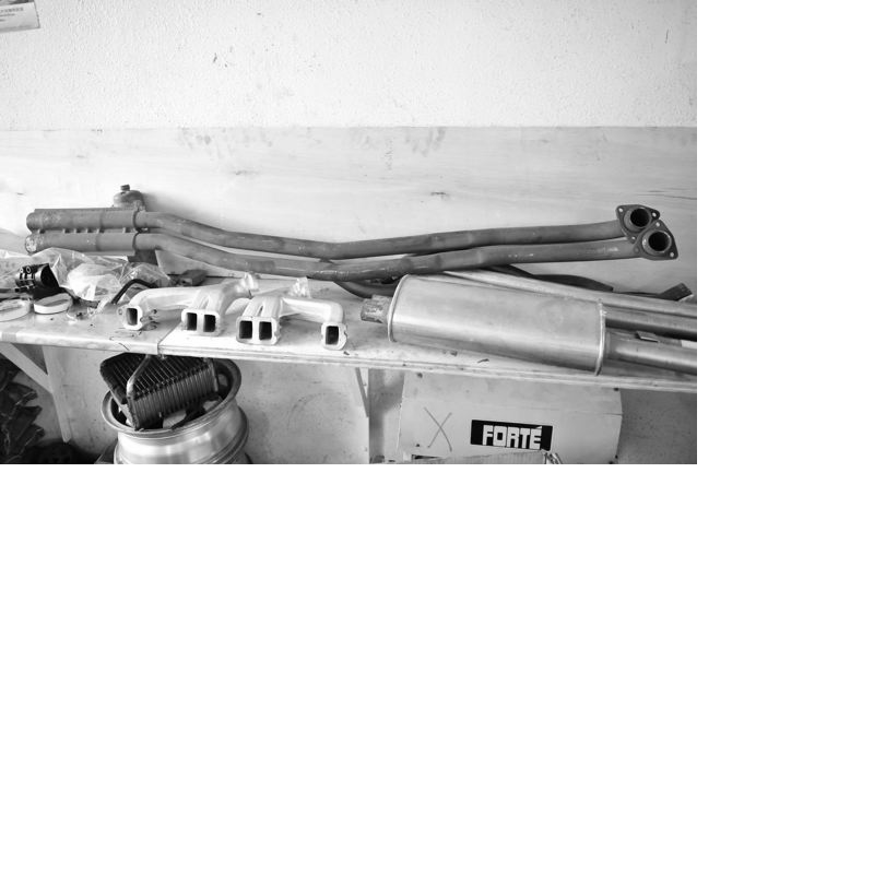

Help please.
Finally got around to installing the exhaust system but there's a problem. I think Niemoeller sent me a LHD part instead.
Sent them a photo but they told me it's the right one and that early 230's (like mine) are different to late 230's.  Is this correct?
The part is in the picture attached. The manifolds are too.  My mechanic tried it and is sure that the right part should be the one pictured in the diagram attached (labelled RHD) and not the part in the picture (pic).
Is there a difference in the exhuast manifold between early and late 230's?

Re: RHD exhaust pipes
« Reply #7 on: August 18, 2008, 21:18:54 »
Forgot to attach the pics.  Here they are:

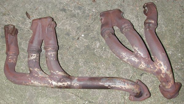

« Reply #8 on: August 18, 2008, 21:20:48 »
Sorry. Here's the other one.
Download Attachment: pic.jpg
234.1 KB
« Reply #9 on: August 19, 2008, 02:03:27 »
Hello, Eryck,
Yes, I think you have been sent part #1 which is the down pipe(s) for LHD cars.
On second thoughts, considering the length of the pipes,I think you do have the correct pipes for the early 230SL RHD. Although the cast manifolds sitting in front of the pipe are for a LHD.
Early RHD Manifolds:
« Last Edit: August 19, 2008, 10:51:09 by naj »
Eryck
« Reply #10 on: August 19, 2008, 04:10:45 »
Thanks, Naj.  That's what I thought.  Then the supplier said that they are sure and that the exhaust manifolds for 'early' 230's are no longer available, so maybe he is referring to the manifolds as seen in grey in the diagram below, in which case, the pipes he sent would fit...umh...
Eryck
« Reply #11 on: August 19, 2008, 21:07:01 »
Naj - you are officially an exhaust manifold expert.  Your picture does look like my old manifold although mine has numberous patches of welding on it and not sure if it's usable anymore.
Assuming not and given that the RHD mani's are no longer available, does anyone know if the later manifolds and pipes would work???
I think my changes are better in finding the later pipes than the older manifolds...
« Reply #12 on: August 19, 2008, 23:45:54 »
Eryck,
The manifolds you got off me would work fine.
You just need the correct front pipes 4,5 and 6
http://www.sl113.org/forums/uploaded/eryck/2008818231846_Pagoda%20exhaust.jpg
« Last Edit: August 19, 2008, 23:47:34 by naj »
