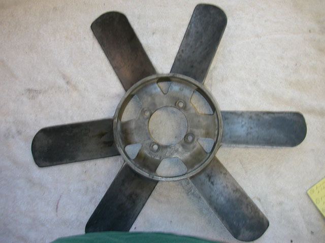

My 113 is a '71 and came with A/C and a 6 blade fan.  In looking at the SLS website, I noticed that they list 8 blade fans for USA cars w/AC.
Should the later 113's w/AC have the 8 blade fan?
Which one do you have?

while my EPC (Electronic Parts Catalog)shows only 6 blades, fan 108 205 10 06, my car (MY1969 US automatic A/C) does have 8 blades.

My Euro '69 280 SL (no Air)has what I believe is an original six bladed metal fan like Bobs

Just to clarify, the reason I am asking the question on the number of blades has to do with cooling.  Every year we all seek to keep our engines from the "red", and to do this, all must be in correct and working order, as MB originally designed.

Not sure it's pertinent to your question, but my '65 Euro 230SL without A/C has a plastic fan with only 4 blades.  The part came from the Classic Center, and replaced an identical fan, so I assume it is correct.  The car never has trouble with overheating.

Yes Chris -- it is correct. The earlier cars had the 4 blader. I also think in general, the earlier cars have less cooling problems than the later ones.

Cannot say for sure. I would venture a guess;   Earliest W113 cars had a fixed four blade fan. The six blade fan was used on later early cars.  The eight blade fan improved cooling a little more on the latest cars. These multiple blade fans moved more air and offset the additional strain and heat from the larger engines, popular accessories like AC and larger alternators, and emission devices.
The trade off is they take a little more horse power to spin the eight blade fan!

I have six on my car.  No cooloing issues with or without A/C on.
