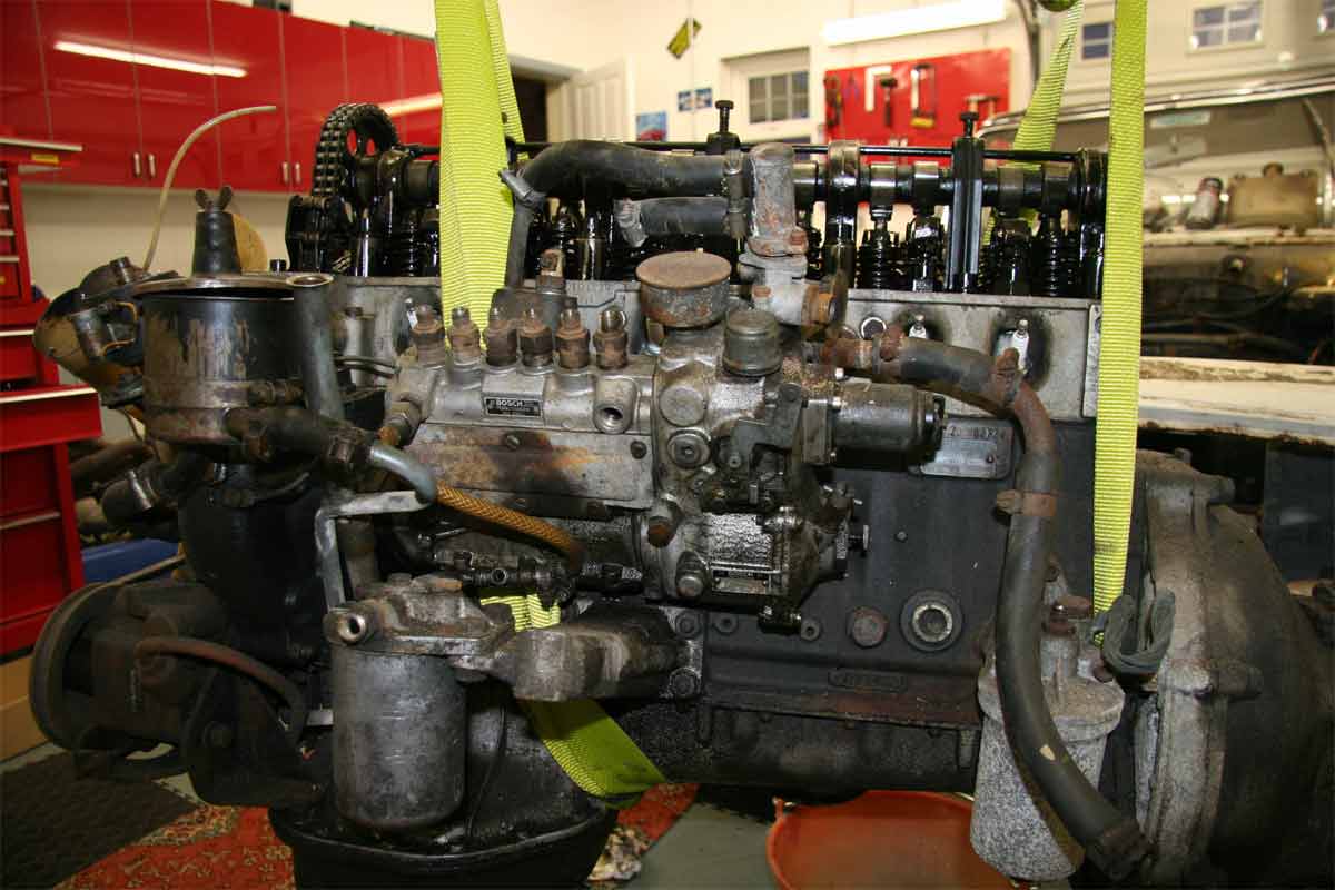

I have now stripped the engine from the car.
Hopefully getting the body ready for some blasting treatment in January.
Download Attachment: in-slings.jpg
74.14 KB
I wanted to strip the car engine down and make some assessment of its condition and planned refurbishment.
I would be grateful for any advice and thoughts from the vastly experienced here.

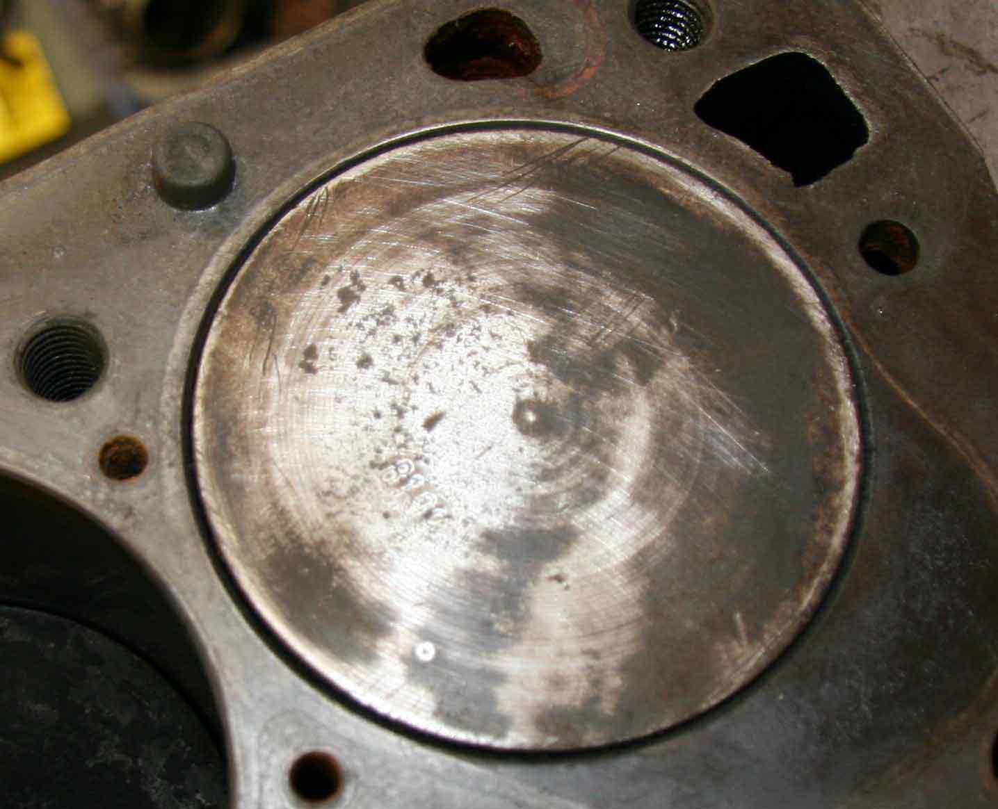

Generally good news once inside.
I think the pistons are standard size (stamped with 81.99 and 81.98) and there was no signs of piston bore scoring or excessive wear.
The Camshaft and Crankshaft also shows almost negligible signs of wear. I plan to chech the Crank Dia. with a micrometer next week but judging by the bearing shells and the look of the cranshaft(they are stamped STD and have minimum wear) I think things are looking very standard.
A mechanic friend who works for Renault was amazed at the overall condition inside the engine and said in his opinion he has seen more general wear on a Renault with 20,000 miles on the clock!
Download Attachment: 81.99.jpg
80.95 KB

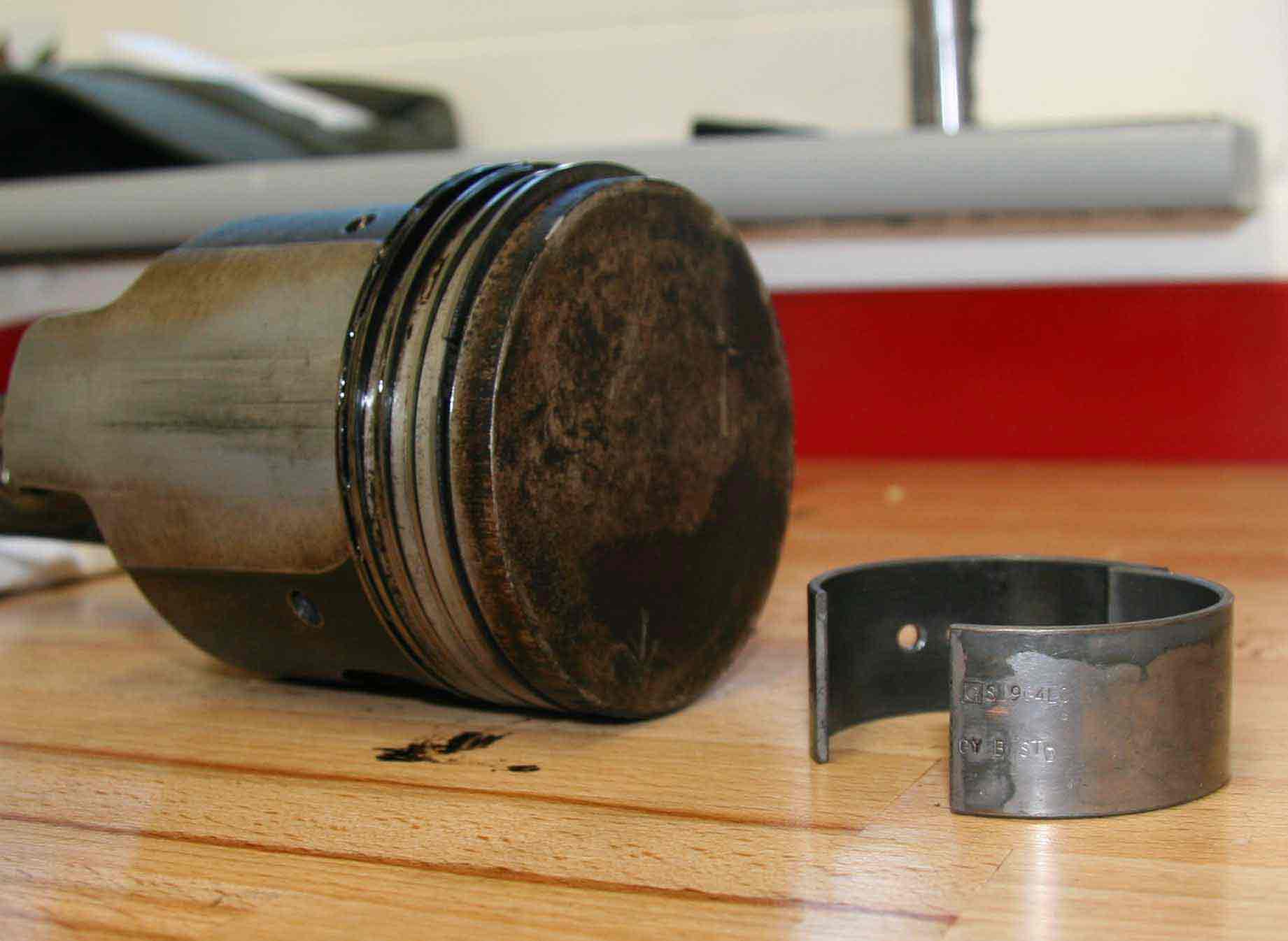

I think these rings are standard but here there is a little discrepency in what I have researched and Haynes manual(which doesnt specifically cover the 230sl).
The Haynes manual qoutes the standard bore as 81.750 to 81.772
SLS link below shows the STD bore as 82.00mm
My pistons also have 4 rings instead of the 3 I would have expected for a 1966 model (the table at SLS suggests only generation 1 early 230sls have 4 rings).
Download Attachment: piston-and-shell.jpg
79.35 KB
Any thoughts appreciated

All but the latest 230SLs had four ring pistons originally as did the other Mercedes engines of the era. 82mm is standard bore for the 230SL some of the M127 sedan engines of the era had a slightly smaller 80mm bore.
Original Mercedes piston rings are extremely hard. Most often the rings are not worn out until the cylinders are shot. In these cases complete oversize piston , piston ring and piston pin sets are ordered to be installed in overbored cylinders.  In this way all wear is removed. Of coarse this is the most costly solution also.
For slightly worn engines, many difficult choices must be made.  Most often replacing just the piston rings is a bit risky. Putting nice new round piston rings in slightly worn, egg-shaped cylinders can cause oil consumption problems. Original equipment rings (ATE) are very, very picey and often too hard to "break in" on slightly worn cylinders. Best success and mcuch less expensive can be an aftermarket softer ring set. I am sure you can get some good recomendations from some owners here. Deves is one choice.
Mercedes is very conservative with the permissable cylinder wear specs. The book says 0.10mm (0.004") wear ! So if you feel a ridge at all you are most likely out of specs! I suspect softer rings would accomodate more cylinder wear than a new  original ATE set of piston rings. Decisions, decisions!
Consider evaluating your originals. They have already adapted to the wear in your engine. You can remove some rings and install them in the cylinders and measure ring gap against original specs. This will give you the combined wear of the rings and the cylinders as a functional unit. Another quick observation ... the fourth ring is one-piece cast iron. Notice it has an upper and lower ridge with a "valley" between. If the ridges are worn down level or close to level with the valley the rings are shot. Judging from your photo your rings seem to be in good condition.
Removing perfectly good rings and installing new inferior rings that do not quite fit the slightly worn cylinders, may not be your best choice?  Hard decisions!
Replacement ring sets are usually softer and easier on cylinder walls. In addition they will wear or break in easier than harder rings. The fourth oil ring may be a three piece steel ring instead of a cast iron ring as original. They can work fine and may even work better in a worn engine, when you must replace the rings. A steel oil ring will damage easier during accidental overheating (loss of  temper). The original cast iron oil ring seems to resist heat damage better. It all comes down to the amount of wear and the decisions you make.
Be sure to check the clearance between the piston ring and its ring groove. The skinny top ring can twist and break if the ring groove is worn too wide.
You can do a visual check on the bearings and measure them with plasti-gauge. Here again, this will give you the combined wear of the crankshaft and the bearing together as a functioning unit.
Keep us up to date, good luck!

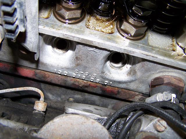

I am now slightly concerned regarding my compression in my 250SL.
I took the car to a very reputable German shop that has done work on our cars for years. After my tune up and valve adjust, the compression in each cylinder was between 130 and 135. Is this exceptable or am I on the low side. The car runs great.
  • Posts: 7524
Re: Planned Engine Rebuild
« Reply #8 on: January 02, 2008, 22:58:50 »
Hello Gregory,
I believe that the compression ratio on your engine should be 9.5 to 1. This ratio is cast on your head below #3 spark plug, just above the block.  You should see the head casting number and the compression ratio under it (9.5).  So If my math is correct 9.5 times one atmosphere (9.5 X 14.7) is about 140. lbs.  You are very close.  Often times engine display higher compression because of the cylinder head being "cut" or carbon build up in the combustion chambers.
Download Attachment: compression.JPG
82.09 KB
Copmpression guages will give false readings. Sometimes a small carbon particle will  lodge itself in a gauge and stay there. Readings with a warm engine can also help readings slightly. I remove all spark plugs before taking the reading. This allows the engine to turn over easily and usually improves the readings.
The rule of thumb is to be concerned when the cylinders deviate more than 20%. Cylinders fail one at a time normally, good even reading like yours are usually a good sign.

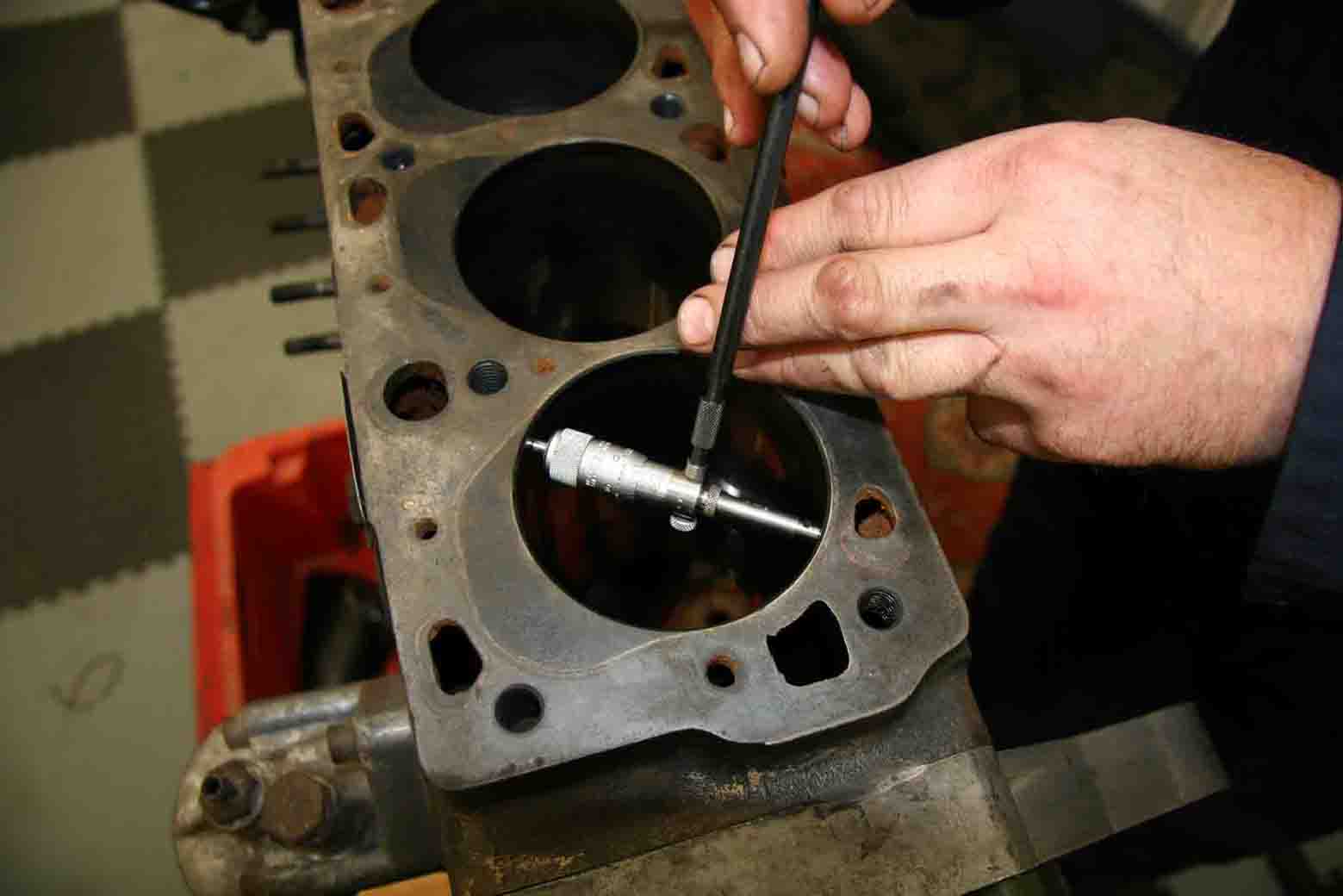

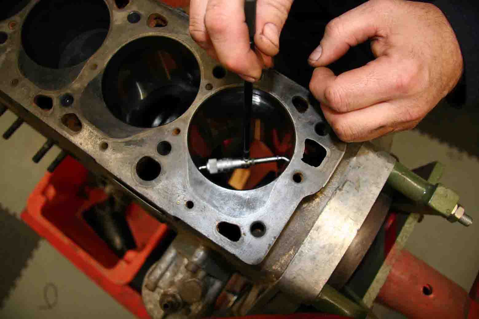

I managed to calibrate the bore gauge today and have carried out further measurements.
Download Attachment: bore size.jpg
70.11 KB
Download Attachment: bore-bottom.jpg
76.94 KB
I am now fairly confident of the readings I am obtaining.
The bore at the bottom in the (no wear zone)is measuring exactly 82.00mm further up near the top it measures 82.200  and at the top just below the lip the widest measurement I am obtaining is 82.245.
All cylinders are very similar.

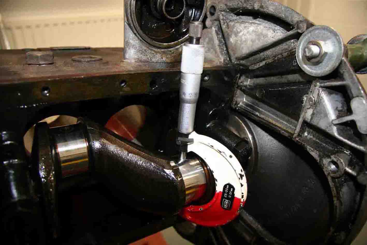

The crankshaft big ends are reading very close to orig spec.
at 47.95
