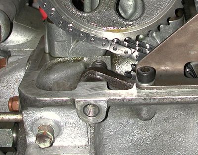

In the process of scanning old posts this morning (from this website and the Pagoda113.com website), I came across a post that has solved an oil seapage question that has puzzled me for some time.  I wanted to share with you as you may also have this issue...  Note: post came from the Pagoda113.com site from "Flips, dated Aug 2004"....
Here is a picture of my engine which shows the oil seapage issue.  I thought that it was coming from the valve cover gasket.  It turns out that it was coming from this screw hole, and the mystery solved with this old posting from the Pagoda113.com site... (read below).  Note: my bolt was installed, but w/o a seal as Dan C. mentions...
"...Here's something to watch out for...at the front of the head, there is a bracket that is supposed to bundle all the fuel injection lines together and attache them to the head. My car only has the part of the bracket that bundles the lines, and I only found out the hard way about the bolt that secures them to the head. This bolt serves a dual purpose. It also retains the shaft that the timing chain tensioner pivots on. The only thing holding the shaft in is......the bolt. I'm still not sure if the bolt was there and loose, or if it was never there, but eventually, apparently the shaft worked itself out of the hole. I had pretty much finished my "to do" list on the car, including fixing the leaky tachometer drive bushing, and was enjoying the fact that I no longer had to keep carboard under the car to catch leaks. I walked up to it in a parking lot one day, and saw a lot of oil under it. "Can't be from me" I thought, "my car doesn't leak anymore". Until I noticed the same puddle the next day. Oops. Like I said the shaft had come completely out, and now oil was squirting out the front of the head, apparently far enough to hit the fan at high rev's, because it's everywhere. Started to fix it last night, but of course dropped the little spring that keeps the tensioner bracket inline with the chain. Had to pull the cam sprocket off to find the spring, but I found it, and now have a plan for reassembly involving several wire ties (one holding the chain to the sprocket, one holding the woodruff key to the shaft, and one to hold the spring compressed), and hopefully I'll be OK. Just wanted to warn some folks about this, though, because I can see how someone wouldn't worry too much about this innocuous looking bolt. I'm just very very glad that the tensioner bracket stayed in place enough that camshaft didnt' get way out of time and destroy the whole engine..."
Dan C. replied with "You also need to place a seal on both sides of this bracket or oil will seep out..."
« Last Edit: December 29, 2007, 05:59:27 by bpossel »

Had a look at the bolt Bob is talking about and discovered that it was not very tight.  I backed it out and found some aluminum threads pieces in the steel bolt threads.  Leads me to believe the threads in the head are stripped.  That's one issue.
I have factory A/C and the A/C bracket is also secured by this bolt.  The bolt threads are 35mm long.  Is this bolt the correct length?  The pin appears to be about 50mm deep measuring from the outside of the A/C bracket.  Does this bolt thread to the aluminum head or the timing chain sprocket arm? Is the bolt supposed to but up against the pin.  I'm wondering if the bolt in my car is too short.  What does the end of the pin look like?
Thanks for the help.

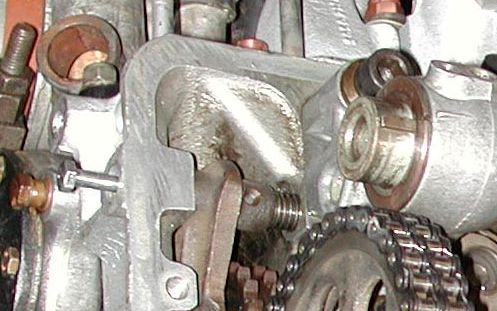

The tensioner pin is threaded so that it can be pulled out with a 6mm bolt:
Download Attachment: TensionerPin.jpg
40.95 KB
Without the A/C brkt,the original bolt is only about 15mm deep to keep the pin in place. It threads into the head.
Download Attachment: TensionerPin2.jpg
51.19 KB

Thanks so much Naj.
The A/C bracket and the fuel injector clamp bracket together are 20mm thick.  That means my 30mm bolt is threaded just 10mm into the head.  If the non A/C bolt has 15mm of thread than I suppose I could go with a slightly longer bolt.  Still means I need to repair the threads in the head.  Any ideas how to do that?  And I just put it all back together.  Oh well.

Found the old bolt !  :oops:
It is 12 x 1.5 and the shank is 16mm long.
Sorry for the anxiety caused ! [:(!]
You'll have to be careful how deep you drill. Part of the head stock supports the tensioner pin as well.

Add another '64 missing that bolt!!   On the 111 coupes the hood opens on rear hinges-hence a missing said bolt is more obvious than on a 113.   The tensioner pin leaves about 15 or 16 mm of M12 1.5 threads in the head for the bolt.  Total bolt length needs, 14mm in the head plus what ever else it is holding.  Mine is just holding the fuel line support and washer so 20mm of thread does it.  JA pointed out the 'joy' of tightening up a too long a bolt.  Applies to removing the pins holding the chain rails.
aside  Bob Possel--  The pins are usually so tight there is no oil leakage.  Having trouble getting out the two pins in the head and the four in the block on a 127.982 engine.
