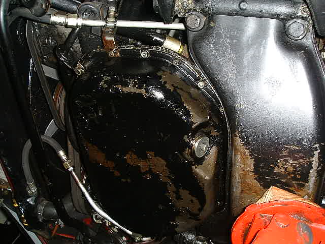

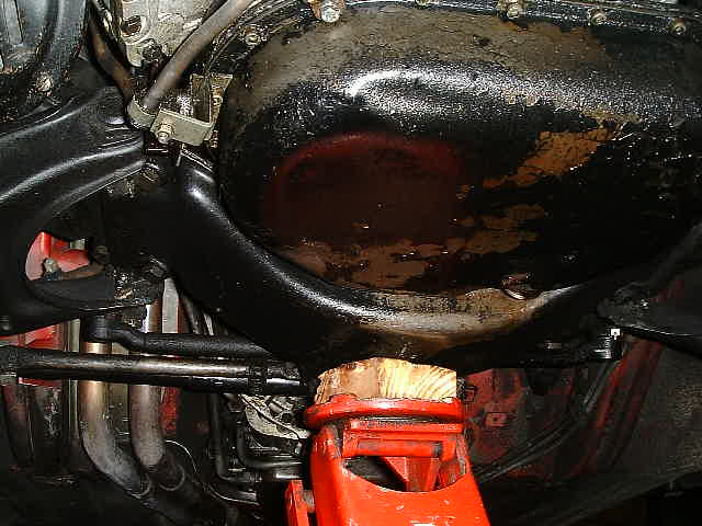

Thank you for the answers. May I re-phrase my question: Attached you find two pictures of the oil pan on my car. Does it look like the original oil pan that came with this model?

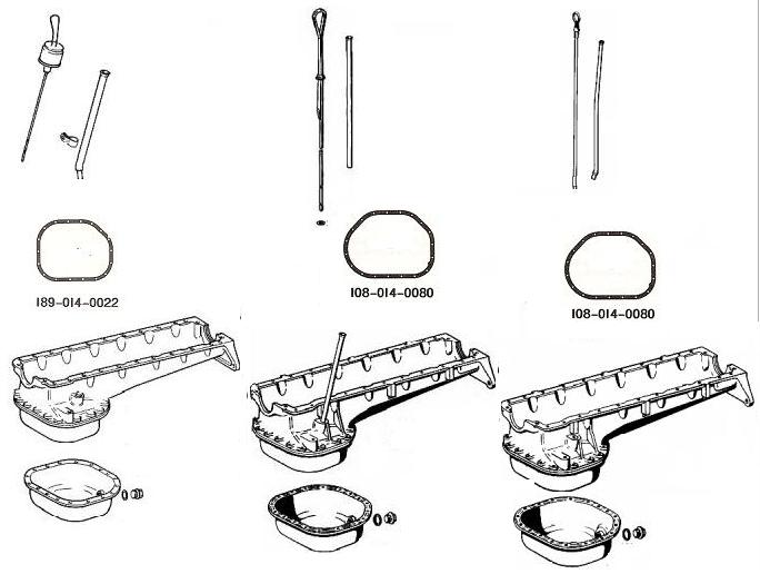

Hello Peter,
These engines have  two piece oil pans. The upper aluminnum pan and the lower steel pan.
The W113 cars actually had three versions lower steel oil pans and at least three versions of the upper aluminum oil pans.
The first  version (lower) used on the 230SLs, 250SLs and various MB sedans, had an 18 bolt, smooth bottom, steel oil pan. It used a pan gasket #189 014 0022.
The second version (lower) used on the 280SL and various Mb sedans, had a 19 bolt, smooth bottom, steel oil pan. It used pan gasket #108 014 0080.
Both these early types used the "larger" drain plug (17mm hex, replaced by the 14mm allen style).
The third  version (lower) #110 010 0313 was actually supplied in Febuary 1972 (after the end of W113 production). These are the correct replacements for the 280SL series and all M130 engines. They have some improved features and are considered an upgrade. This last version is a 19 bolt, "ribbed bottom" steel oil pan with a smaller 13mm hex drain plug. This version is deeper and increases oil capacity 0.5 liters. The ribs add strength and slight cooling capacity to the steel pan. The smaller drain plug has less of a tendancy to be knocked loose from road hazards.
Download Attachment: versions.JPG
44.88 KB

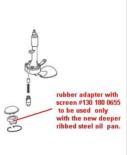

The factory supplies a rubber adapter for oil pick-up for the oil pump to be used with the new "ribbed" pan. It extends the oil pump pick-up furhter into the new deep pan. This adapter along with the oil pump strainer #130 180 0655 should be replaced before installing the ribbed pan.
Download Attachment: adapter.JPG
13.1 KB

Some facts; You cannot replace your 18 bolt steel oil pan with either 19 bolt oil pan unless you replace the upper aluminum oil pan also. You can replace your smooth 19 bolt oil pan with a steel ribbed version as long as you add the oil pump adapter. You can convert your earlier engine by changing the upper aluminum oil pan after which you can use the latter improved ribbed steel pan. be aware that the dip stick arrangement in these pans vary slightly also so you would need the correct dip stick also.
The latest versions of Factory Shop Manual cover some of this information Sec.  18-6/1
I will post photos in the next couple of days.

Picture of oil pickup that Joe refers to:

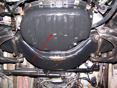

Picture of ribbed oil pan that Joe refers to:

Yes, Bob's second picture is of the last version ribbed steel oil pan with the small 13mm plug. These were not actualy supplied with the cars when new, but are the correct replacement parts from Mercedes. It increases oil capacity by 0.5 liter.

The new rubber pick up is to be used with the ribbed oil pan.There is an early and late version rubber pick up. The late one is only to be used with the deeper ribbed oil pan. This late version rubber pick-up is 48mm in diameter and is 34mm high compared to the early version which is 45mm diameter and 16.5 mm high.
When fitting the later version, the metal strainer and rubber pick-up are changed together part #130 180 0655
Refer to page 18-6/1 and 18-6/2  if you have a BBB.

Joe is right about this. Thse are things you find out the hard way and it's a testament to this site that you don't have to go hat route.
Fitting the late style pick up into an early style oil pan wll pretty much crush the rubber pick up and possibly damage the oil pump strainer.
