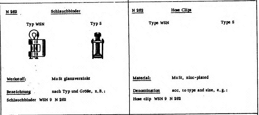

Hello Bob,
I believe the rear axle boot originally used the "S" type clamp.
Download Attachment: S clamp.jpg
42.44 KB
I hear these are no longer available. So you may want to try to salvage any originals you have. The metal straping is not special and can be replaced. The clamping mechanism is unique.
If you are not overly concerned about such a minor detail, the one thing to consider when replacing the clamps is the width. The original clamps are not as wide as your standard USA hardware store variety. the groove in the rubber of the axle boot is made for the less wide clamps. Most likely any good clamps will do the job, but having ones that fit right is a plus. Original Mercedes clamps do not have the cut slots in the bands of the clamps so they do not extrude and damage the rubber as the clamps are tightened. In addition the sides of the newer Mercedes clamp bands are slightly beveled upward so their side does not cut into the hose.... Just a minor detail but better quality.
Mercedes used to supply a split boot clamp kit #110 357 0591 which contained the clips for the split axle boot and the correct size and width clamps for the boot. These clamps were a more modern "Norma" style clamp, but were the correct width. The kit was only a few dollars from the dealer. I am not sure if it is still available.
