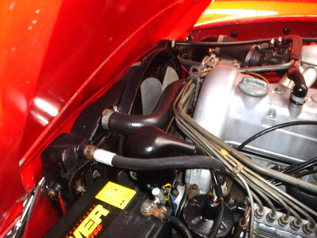

In the pic near the battery there is an air intake that doesnt appear in the pics i saw...Is it a 280 sl engine?Strange Vin with 14 digits 113 044 12 018744   ( the last four is the digit?)

Sure looks like a 280 engine to me... albeit with a strange cover over the distributor. Is this what you're referring to as an "air intake"? I would peep underneath it to check to see if the distributor is the correct type.
The actual air intake is on the other side of the engine, next to the headlight (you can see it in this picture).

Yes a strange cover over distributor. The air intake is at correct possition I saw.
Thanks a lot.

The distributor cover is original for a 280sl
I guess that most of these have been discarded over the years.
I have one on my 230sl, most likely not original but I put it on any way because I like the look, there is also a cover for the coil.

The distributor/coil covers are meant to reduce radio interference but are also good protection against moisture and water splashes (though not many owners like to take their cars out in the wet  :evil: )

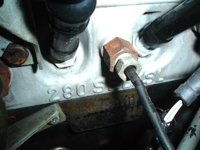

One more pic of the block with the engine number is a 130 .193 , and it has the big number 280. But Not 280 SL but 280 SE(B) SL.
The guy says it is original. I am thinking in head cover change !
I will drive 500 Km to see and drive it.

I do believe you have the right engine.
The engine # should read 130.983.12.xxxxxx
The same head is used in the 280 SE and SL
Can you get a copy of its data card?

The Head PN in the pic : 130 016 17 01 do not return in EPC as a part number . The correct ones are 130 010 26 20 and 130 010 67 20 for manual and auto cars.

Fernando,
have a look at this table:
http://www.sl113.org/forums/uploaded/ja17/200441225611_cylinder%20head%20and%20gasket%20chart.jpg

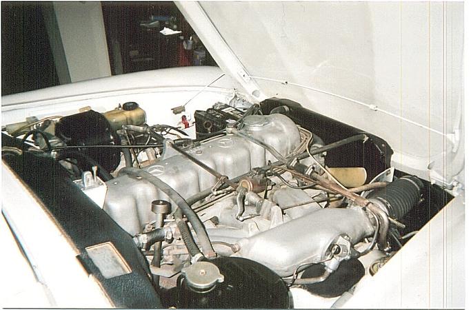

Thanks Al. I don't think mine has a breather. If you look at this rather grainy picture, you can see the dipstick top (near battery). Anyone else's look like this one?

James,
Have a look at this discussion:
http://index.php?topic=450

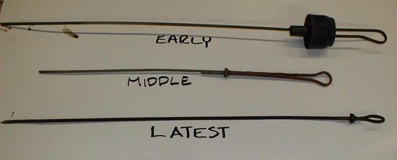

I had forgotton about the latest, longer, thinner version on the M130 motors. In this photo posted by Joe in another thread
my car has the one in shown the middle.
James must have a replacement block made later than mine and has the dip stick shown on the bottom. The one in my car extends up only to the P/S tank and wouldn't be visible from the right side of the engine.

Thanks Naj for the link. I recall that thread -- but remember thinking how could I have a 280 dipper with a 230SL (since joe mentioned they are not interchangeable)... I guess the MB replacement shortblock really is a horse of another color. My dipstick sure resembles the 280 one...
PS are the 280 dipstick rings red? Mine is more of a beige plastic.

The quantity of oil for the engine with filter change is around 6 litres (or quarts???) I believe. Make sure your engine is getting enough oil.

Hey Naj. That is actually one of the practical reasons I was asking. I'd hate to be checking oil with the wrong stick. But every time I change the oil, it usually comes out to 5.8 or so quarts. Now when you guys check oil -- is it best to check on a warm engine or a cold one?
