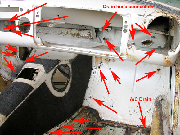

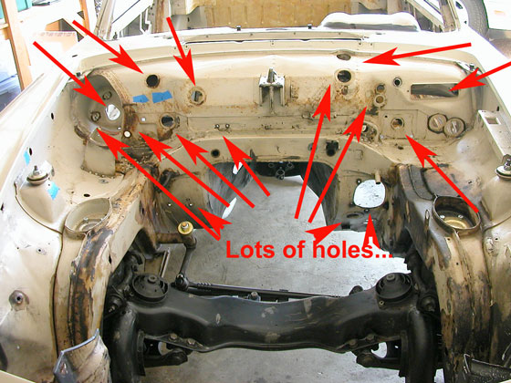

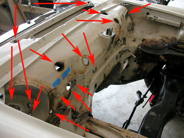

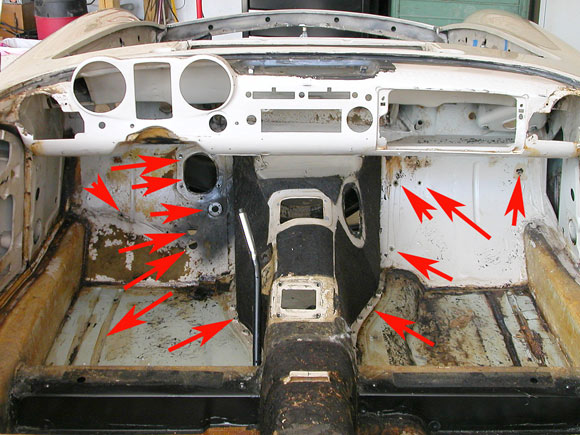

Hi James,
Having recently taken apart my car, I can say that there are many places that water can come into our cars...  Going from memory and attached pictures here are some of the possible sources of water inlets ...
1. Left & right underdash hoses that drain the water from the fresh air scoop area.  (you already mentioned this. Replacement hose is std heater hose, nothing special...).  I read somewhere that when you wash the car, or if in heavy rain.... to close the fresh air scoop to avoid water in car.  Not sure if this is accurate, especially when the windshield starts fogging up on those rainy days...
2. Wiper transmission "pins" that go through the firewall.  I noted a rubber washer on the exterior of the body, as well as a rubber washer on the inside of the body.
3.If you have A/C, extra hole that was cut in on pass side foot well to drain A/C
4. Carpet/Mat snap screws (screws go through floor)
5. Kick down switch (has rubber washer)
6. Extra hole in floor next to kick down switch for wire
7. Another hole next to kick down switch. I think this is for manual clutch cylinder?  Not sure what hole is for?) Has rubber plug if not being used
8. Transmission plate bolts.  Holes go through floor
9. Screws that hold the brackets for the main fuel, brake lines go through the floor.  These have small rubber washers.
10. Bolts that hold the wiper motor have rubber washers
11. Windshield rubber (already mentioned)
12. There is a large rubber washer (seal) where the steering shaft cowl connects to the floor
13. Rubber seal around the fuse box
14. Rubber plug covering access hole for heater valve
15. Screws that hold the muffler down-pipes heat shield go all the way through the floor.  Another viable source of water into footwell...
16. Many holes, rubber plugs on firewall where water could come in (?) if rain was extreme and water ran down firewall...

Thanks all. Bob, your photos are awesome! Informative (and a little depressing -- since I know many of my various grommets/seals are shoddy at best)...

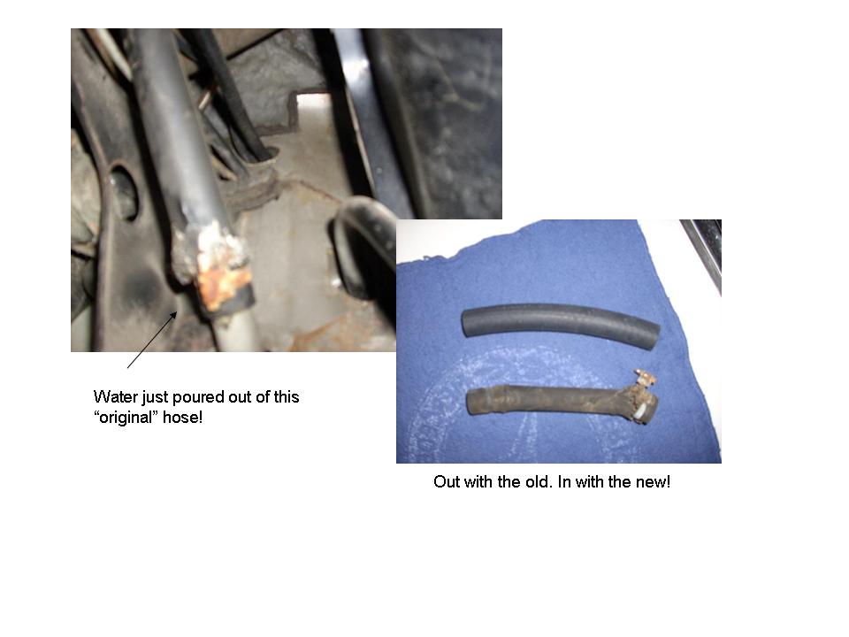

Anyway, I replaced the hoses today. The passenger's side was not bad but I replaced it anyway. The driver's side looked like this:
Download Attachment: Slide1.JPG
46.32 KB
Unfortunately, I am missing a number of plugs/grommets. However, for now the drains are clear in the front. I will have to check on the backs...
