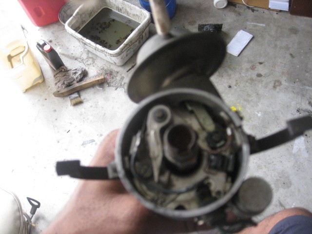

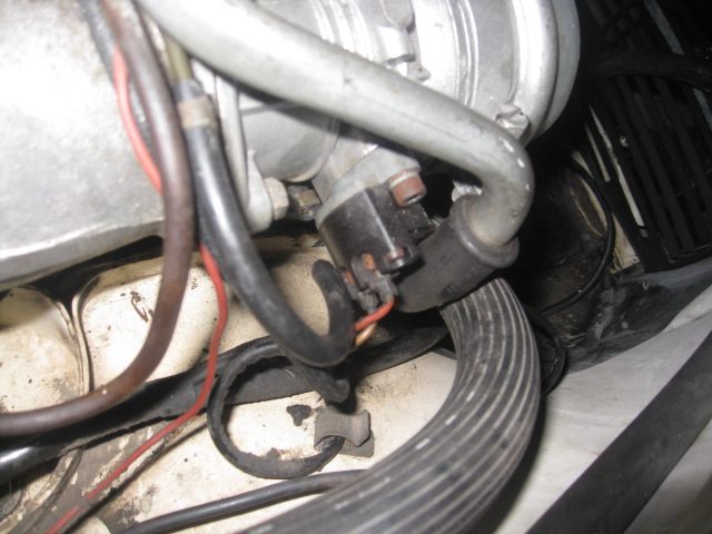

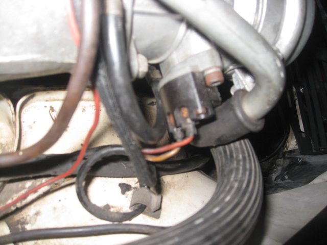

My 66 230sl was parked for a long time, I started it but it does not sound right, also back fires through the intake manifold at times. It misfires erratically as well.
My suspicion is the distributor. In reading George's thread and the wiki, I suspect I have a retard manifold and advance distributor. Attached are some pictures (I will try and load them). The advance pulls the points CC, the vacuum pipe take off on the throttle is underneath the body.
My dist number is 0 231 185 007 (JFU 6). The wikki list this part number remarks column with "changed. The Bosch number reads as 0 231 116 046.
Please advise.

Re: Vacuum Advance retard Saga
« Reply #2 on: December 02, 2007, 12:57:36 »
Hello, MBP,
I agree with your findings:
0 231 185 007 is indeed a vacuum advance distributor and superceded the cast iron 0 231 116 046
Your throttle body is the later vacuum retard type. This body was used between engine #s:
Manual trans:(10/20) 010787 and 014471 and
Auto trans: (12/22) 002991 and 005668.
For interest, what is your engine # ?
Could you post a picture showing the full throttle body for us to include in the 'wiki'? We're showing the later one with the vent pipe from the valve cover on top of the throttle body.
Also, if you have part #s for the points, dist cap etc, it would help us to fill some of the blanks in the parts table.
Hope this helps.

Try running the engine with the vacuum line disconnected. However, the port must be sealed to stop the air to the throttle body. Also check for other air leaks ws well.
Let us know what you find.
