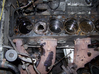

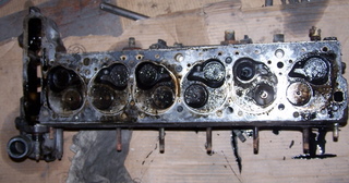

any ideas would be appreciated
Download Attachment: Merc Engine Pic 1.JPG
51.06 KB
Download Attachment: Merc Engine Pic 5.JPG
37.56 KB

Hello ejm,
Looks like you dropped an valve in number five cylinder. Usually happens after a valve guide comes loose in the head and the car is kept in use. Eventually things wear, shake and rattle around so much that the keepers let go dropping the valve for  a short ride on top of the piston.
