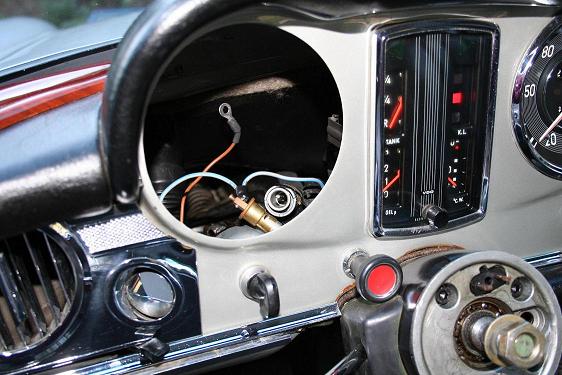

Any suggestions for unscrewing the cable nut on the back of the tach? I took out the seat, the steering wheel, and moved the wiring harness to get good access.  Now I can't get the tach cable nut off the back of the tach.  Finding a good hand position for leverage is hard, for sure.  Any suggestions?  Thanks in advance...
Craig

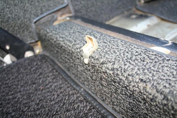

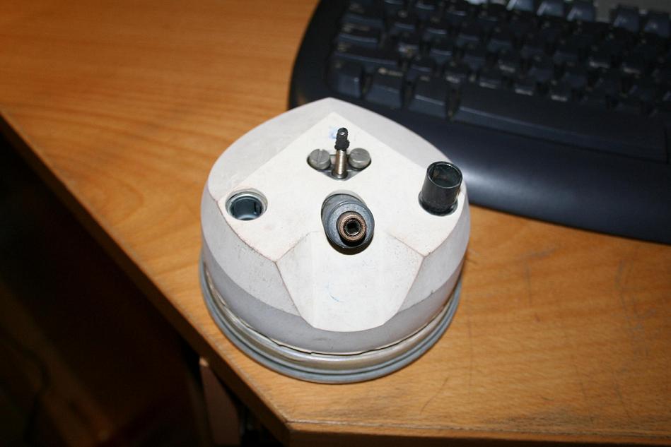

I have 2 questions:
1.  The second photo below is the back of my tach.  I noticed the bulb sockets are different... one has the black plastic holder and one doesn't.  Is this correct?
2) In the third photo, what is the bracket centered beneath the front seat?
Thanks for the help,

  • Posts: 7507
Re: Rev. counter removal - 1970 280SL
« Reply #21 on: January 01, 2008, 22:58:57 »
Hello Craig,
Your light sockets are correct. The one that sticks out has an insulator around it. I am not sure what the bracket is. It may be a seat stop?

« Reply #22 on: January 02, 2008, 04:34:11 »
Download Attachment: IMG_5167sm.JPG
69.67 KB
Craig
'70 280SL Euro, Manual,  Leather
Silver/Black
Is it a fire extinguisher mounting bracket?
« Reply #23 on: January 02, 2008, 10:26:35 »
Originally posted by naj
James,
This plastic plate may have detatched itself from the 'horn pad'.
Just pry it off with a screw driver or similar implement. Its held by three plastic 'press on' type studs.
Hi Naj, sorry, I must have missed your response! Thanks, and thanks Joe for reminding me... I bet you all are right, the upholstered part has lost its stick -- and comes off fairly easily. Actually bugs me as it goes cock-eyed once in a while. Time to glue it back on!
« Reply #24 on: March 22, 2010, 02:52:18 »
In fact, Bob is exactly correct. That little bracket in front of the driver's seat is for the fire extinguisher.
